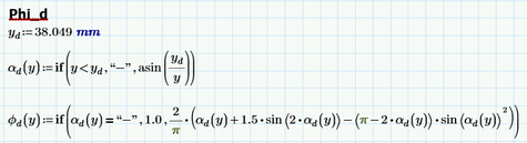

Hello
I have a written two programs which are very similar. However, when I am running the second program, I get an error message saying "these values cannot be compared".  Unfortunately, I can't figure out what is wrong with the script. How can I solve this error?
Thank you for your support!

I would say that the error message is misleading and showing the wrong position.
The only difference I see is that you use function Phi.d in the second calc instead of function Phi.p.
As a first quick workaround you can throw in a try and catch statement
So it can be seen that the last two values in vector y are throwing the error
I turned your calculation into a function of y and it can be seen that it works OK for values of y smaller than 58 mm and throws that error for y=58 mm or larger. It works again for y>108 mm.
The error message sure is misleading because the expression where the error is shown is independent from the value of y. Nonetheless the value of y and something in the function Phi.d seem to be responsible. Could not be tempted to further look in your function definitions with those nasty nested if functions.
Phi.d itself has no problems with values of y larger than 58 mm.
I defined the function g dependent on N.p you are looking for its zero and used y=60 mm (a value where the calculation would fail),
It can be seen that there is no zero of this function!! Because of the various if-statements in your definitions of the various functions involved we can clearly see a jump from negative to positive values somewhere between N.p=1242.562 kN and 1242.563 kN.
So root can't find a solution. My guess as of this misleading error message is that root in its desperation might try values for N.p which may return non-real results in some functions (possibly delta.0). Not sure about this, though.
So the solution is that you have to check your functions and make sure that they are continuous where you are looking for the zero of  a function.

Thank you for your responses Luc, Stuart and Werner! Very appreciated!
As you already mentioned, the only difference between the first function (which is working) and the second function (which is not working) is Phi_p and Phi_d. I have investigated this further and can not see where the problem is. I have also solved this interation before in Excel, so I know it is solveable.
Is there any workaround for this or any error that causes some roots to be missing for Phi_d?
Thank you for your help!
As I had shown the equation you are trying to solve simply has no zero for a certain range of values. This is due to the discontinuity which Luc mentioned i I showed in the pictures.
Prime can't find a zero which dos not exist, so I can't think of any "workaround" other than going back to the start and look where this jump comes from and fix the appropriate function definition, making it continuous.
Thank you
Could you please clarify what do you mean by "fix the appropriate function definition" and "making it continuous"? Aren't both Phi_p and Phi_d continuous?
See the last but one picture in this reply: https://community.ptc.com/t5/Mathcad/Error-message-These-values-cannot-be-compared/m-p/990961/highlight/true#M215566
Here I had chosen y=60 cm, a value where your calculation using the root function fails. The function g(N) represents the expression you use in your root function. This is the expression which you want to be zero and look for the appropriate value of N.
And the plot clearly shows that there is no value of N which makes this function to zero because there is a discontinuity at approx N=1242.562 kN
The root command can't find something which simply does not exists!
I have not investigated further which  if statement is responsible for this jump - thats something you should be able to find much faster I guess.
The thing that I find strange is that the functions Phi_p(y) and Phi_d(y) are more or less identical except for the fact that y_p and y_d (constants) differ and there is no problem solving the roots for the Phi_p function only for Phi_d. I have a hard time understanding that.
Your task sure is to find out where the step, the jump in your expression stems from.
Its present for all values of y. depending on y the graph seems to be moved up or down. As long as the jump is completely in the area of negative or completely in the area of positive values, all is OK as the function (my function g() which is the expression you want to solve for) is continuous in the area of its zero. but when the graph is move so that the jump is from a negative to a positive value, not zero value exists.
