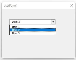

You cannot change the Prime ComboBox with API code.
If you input a value to the combobox alias you delete the Prime Combo Box.
You can fully programmatically control a combobox as part of VBA coding.
Simply create a userform and add a combobox in VBA.
