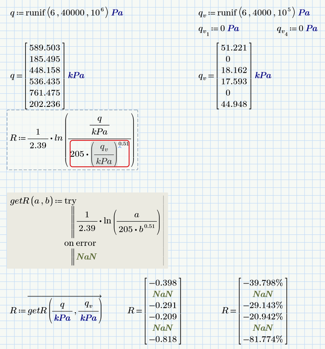

How can I exculde some values to get the function runing without affecting the results?
I want to exulde the zeros.
It is on page 28
Thanks in advance

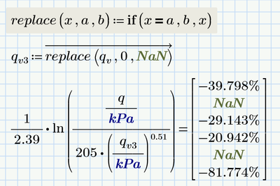

If you really prefer to rather modify the vector, replacing zeros by NaNs, you may do it like this:
Personally I would prefer using a more generic, versatile utility function

Why don't you just use "try... on error...." in the calculation of R ?
BTW, writing 100% has no effect, its just a multiplication by the number 1.
If you wan the result to be displayed as % value, you have to format the result accordingly.

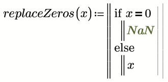

(To:YA_10963798)
@YA_10963798 wrote:
Hi Werner,
I hope you are doing well.
I have a question >> Is the (if) you used in your answer the same (if) in the programming dropdown list or it is kind of different? because I couldn't it write it
No. its not the program if-statement but I rather used the if function.
Simply type "if(" and you will see that the letters "if" change from italic to to upright boldface, indicating that they are now labelled as 'Keyword' and  not as "Variable'.
The if-Function is very similar to the 'if" command ins spreadsheets like Excel.
For more complicated expressions its harder to read, but for simple ones I prefer it because it takes up less space than the if-statement.
The following two functions are equivalent and you can see the difference:
The first one has the additional advantage that is also works in the free Prime Express version.
In the second we could delete the vertical program indicators and now that function would work in Express, too. But I think it could not be created from scratch in Express.
You could also use
which works because 'return' quits the program and so the last line is only evaluated if x is not 0.

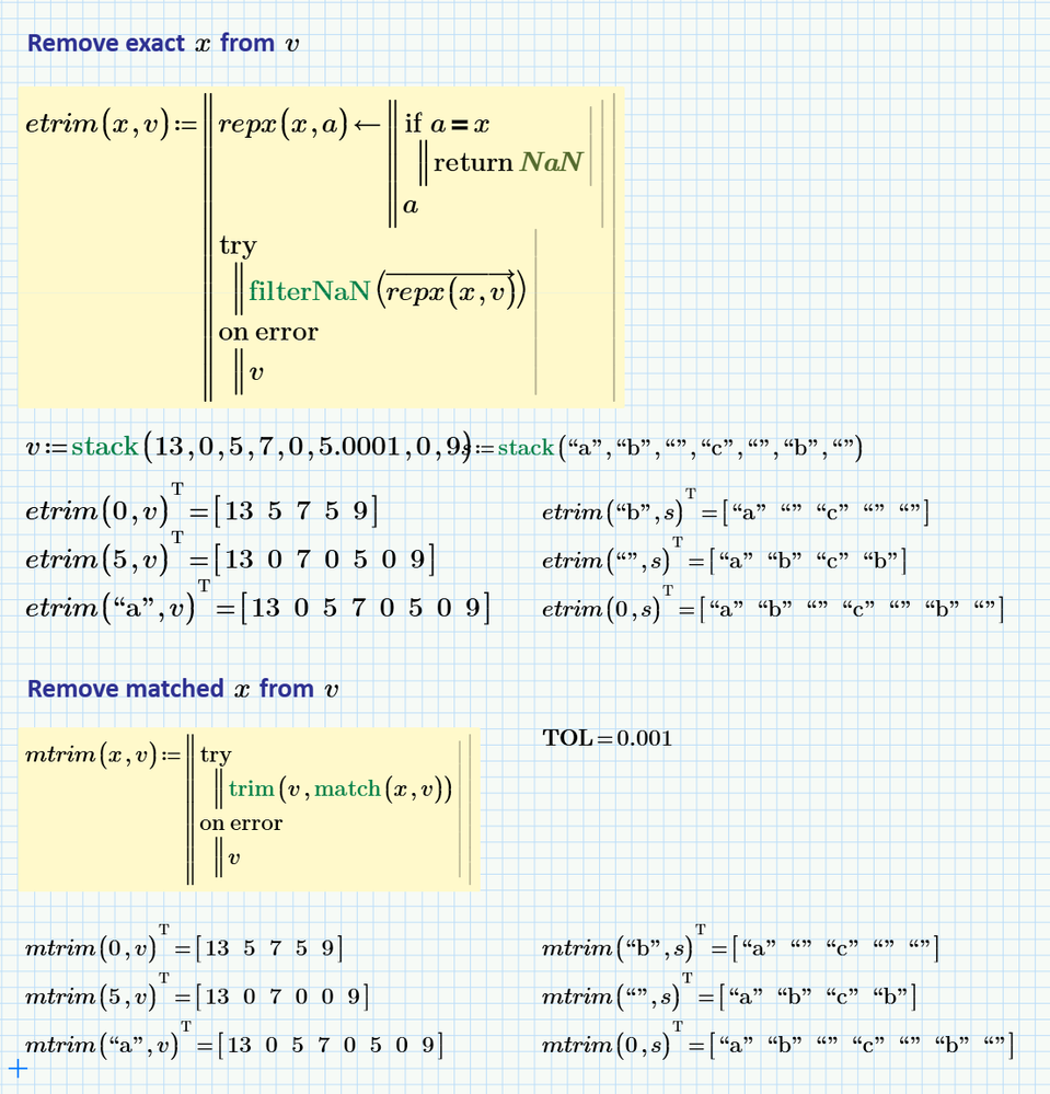

If someone really wants to exclude values from a vector, ...
I've been bitten before by forgetting that Mathcad's lookup function definition of "eq" means to "be within TOL".
I couldn't decide whether to use match's or trim's argument order, so when in doubt, opt for the most confusing.
