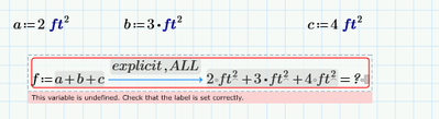

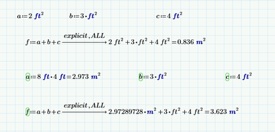

Maybe I'm doing something wrong, but I can't seem to figure it out. There are several posts that show examples of explicit working quite well, but for some reason I can't get it to work.

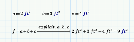

Here is what I'm trying to replicate:
And this is what I get:
Also, is there any way to hide the whole "explicit,a,b,c" part?
Thanks in advance.

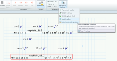

(To:WC_11081661)
You should turn ON units... in symbolics via the calculation options
and then recalculate the worksheet (press F9 or F5).
You may also use "explicit, ALL" and of course you always can manually change the unit meter to feet in numerical results:
For future questions please attach your worksheet if ever possible because its hard and tedious to debug just a picture.

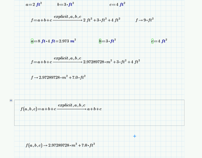

Can't replicate your problem:
You can hide the area but looks like not so explicit any more.
What if you did something like...
Also, hiding the keywords in a symbolic expression is a common feature request but as of Mathcad Prime 10, not currently implemented in Mathcad Prime.

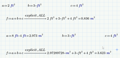

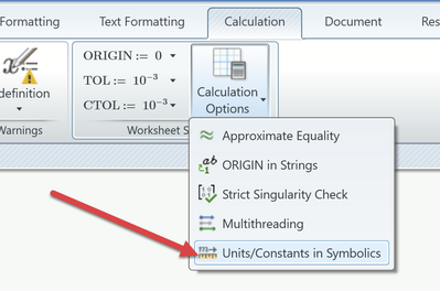

I get
I am... confused at myself, yes.
But then it liked this:
I manage the Creo and PTC Mathcad YouTube channels for PTC, as well as all PTC Mathcad marketing in general.
Okay no I'm pretty sure that the difference is Units/Constants in Symbolics and then actually hitting the Calculate button to force it to calculate.
ppal
(To:DJNewman)
F9
and I get
