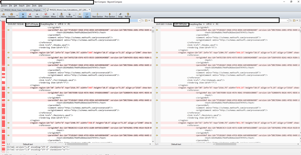

Hello
as requested the comparision of two conversions:MC15 in Prime 7 Converter - Comparision of several conversions.png
cite: You'll have to write your own converter, examining the XML of the Mathcad file.
TBH: If it would be so easy as you said then the competitors would generate a input interface. But they don't do it. Second: I am a HW engineer and I do not write a script to parse XML. This is not my job. My employer pays much money to get a maintenance and I receive a converter which works sometimes sometimes not. I want to trust the converted scripts. And I don't want to check each formula if there is an error or not. If I would print the WCA on a paper I would waste 200 pages of paper.
@MR_9994284 wrote:
Hello
Thats indeed surprising but I guess that you don't find any differences when you open both sheets in Prime, correct?
Sometimes files for various reasons contain dummy data and that may be arbitrary date from the memory which may be different dependent on the time of conversion. I am not sure if thats the case with the Prime sheets but it might be an explanation for the difference when doing a binary comparison.

I'm not at all convinced by the 'proof' you provide for difference in conversion. Assuming your source sheet for conversion is a .xmcd file:
Open your mathcad 15, open your source sheet, calculate it and then save the file as an .xmcdz file.
Now close Mathcad 15.
Now repeat the first action, but save the file to a different name (but still a .xmcdz file).
Check the file sizes...
I bet that this way you'll show that even your source sheet for the conversion 'is different'.

As requested I run the script and stored it under different name.
Here is the result:
LucMeekes
(To:MR_9994284)
QED
(and that's not Quantum Electro-Dynamics, but latin: Quod Erat Demonstrandum).
