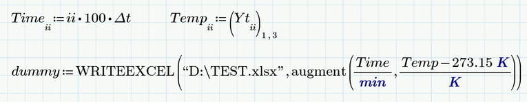

What you create using the range ii are NOT vectors, even if they look that way. Thats the reason you can't use them for anything further.
Here is a way to properly create the vectors and use WRITEEXCEL to export the data:
You have to divide by the correct units otherwise the values in Excel would represent the standard Mathcad units which would be seconds and Kelvin. Getting rid of the Celsius unit is a bit tricky as you can see (you can't just divide by °C),
In case you don't want the data to start at cell A1 you may use the optional range argument of WRITEEXCEL.

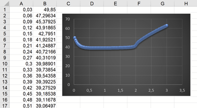

You're a lifesaver! Thanks a lot, it works smoothly now.
