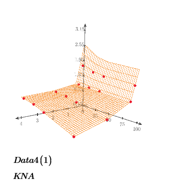

0. Make all Delta=100 data by linterp function.
image.pngimage.pngimage.pngimage.pngimage.pngvx = Ratio and vy = Delta.

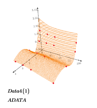

1. Using Bicubic2D function.
2. Using Werner_E's linterp_2D function.

You may also try splineInter_2D() for a similar result like Bicubic2D

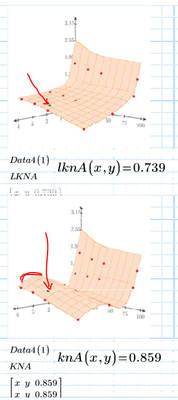

My next step is to research the data set to determine the most appropriate interpolation method, piecewise polynomial or linear. For instance, for Data Set A, polynomial interpolation produces a smooth peak when transitioning from a ratio of 2 to 4 for low Delta values. Any A value interpolated in that range will be higher compared to the linear interpolation method.
Below are the comparison results between my implementation (2D linear) and yours.
ttokoro
20-Turquoise
(To:Perez)
The difference is caused by the behavior of two functions. SplineInter_2D shows more flat shape. And linterp_2D fit all points data on the plot.

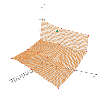

This is a good comparison plot. I will consult the data owner on their preferred method and assess the downstream impact of using the higher value. Please attach the Mathcad file so I can examine how to add the green point to the plot.
こちらは良い比較のプロットですね。@ttokoroさん、ありがとうございます。データの所有者に、好みの方法について相談します。また、より高い値を使用した場合の下流への影響を評価します。プロットに緑の点を追加する方法を検討するために、Mathcadファイルを添付してください。
(To:Perez)
To add a single point in a 3D plot you have to plot that point twice, otherwise an error is thrown.
Assign the x- and y values and then let the 2x3 matrix shown below be plotted.

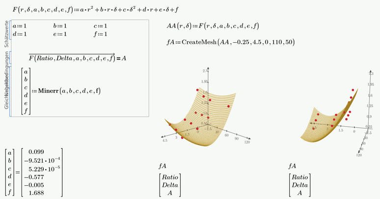

What irritates me on @ttokoro 's picture is this
even though he seems to just use interpolations and not a fitting function some points seem to be not part of the surface which should not happen when using an interpolation. But maybe thats just because of a bad choice for the grid size. Can't tell as @ttokoro  unfortunately as usual did not attach the worksheet in fist place (but he sure will do later because you asked for it).
Speaking of surface fitting instead of interpolation - you just have 13 points of the surface at hand. Thats quite few but you can fit any surface function to the data anyway using a solve block with "minerr".  Not sure what the final intention is and IMHO a surface fit only makes sense if you know what kind of process the data stems from and what kind of (surface) function the data can be assumed to lie on.
Here an example where a simple polynomial function of second order is fitted to the data. As you can see, the fit is pretty bad and a lot of the data points are way off the surface
This was just an example to demonstrate the use of the solve block. For polynomial fits you would rather use the built-in "polyfit" function which is much more convenient.
In the next picture you see polynomial fits of third and fourth order
Prime 9 file attached

I have a question regarding the mesh: How can we keep the mesh within the limits of the data points? As illustrated in the image below, I would prefer that the mesh does not extend beyond the data points (indicated by the blue hatch).
ttokoro
20-Turquoise
(To:Perez)
CreateMesh makes data for Adata(x,y) of x from 0 to 4 and y from 0 to 100. So if you want x from 0.25 and y from 5, just change  CreateMesh(Adata,0.25,4,5,100, number of x mesh, number of y mesh).
Perez
(To:ttokoro)
It's working correctly. This allows me to visually verify that the interpolated value falls within the defined surface area dictated by the available data.
