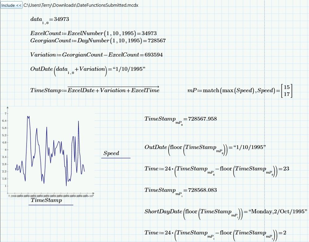

I have not altered the Excel file.  Reading it with READEXCEL() in Mathcad gets the Excel day number days since 1/1/1900 not a text date and the time as a fraction of the day multiply fraction by 24 to get hours etc
What is missing is a way of reading the time stamp in day number and fractions of a day and returning the text date and the time.
Converting an old C++ Georgian calendar date functions to Mathcad then to Prime this is no longer a problem.
You just have to change the day number from Excel to Georgian which is just an addition.
