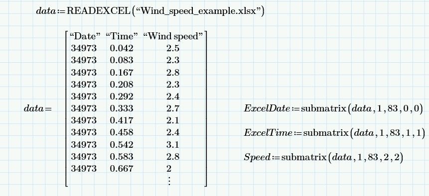

Can you provide a sample Excel file (thinned out heavily, of course 😉 so we can see the exact format, headers, etc.
You may try to read in the Excel file using READEXCEL() and then loop through the data, resetting the max so far if July pops up again.

I have not altered the Excel file.  Reading it with READEXCEL() in Mathcad gets the Excel day number days since 1/1/1900 not a text date and the time as a fraction of the day multiply fraction by 24 to get hours etc
What is missing is a way of reading the time stamp in day number and fractions of a day and returning the text date and the time.
Converting an old C++ Georgian calendar date functions to Mathcad then to Prime this is no longer a problem.
You just have to change the day number from Excel to Georgian which is just an addition.
