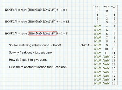

Hi All
Help required as below. Thanks and Happy New Year.

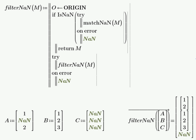

(To:ppal)
Simply write your own, modified "filterNaN" using try and catch
Note, that you may still run into problems if the argument contains a NaN in every row. You will get back the argument unmodified. Thats no along the logic of the function as you should get back kind of an empty matrix (which unfortunately does not exist in Prime).
In your pic you write that you expect 0 as a result. I guess you'd rather expect a return value of 19!

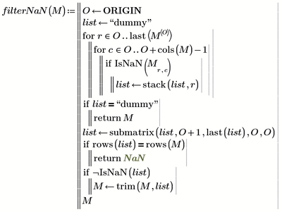

(To:Werner_E)
Here is a routine which returns NaN in case all rows contain a NaN.
At least rows(NaN) returns 0 so it will work OK in the context of your example:
(To:Werner_E)
Guess its easier that way:
Hi
Thanks for that. The data will only have NaN  after the end of valid numerical values. They will not occur in beween valid numbers. I have attached a sample dta file and a mathcad Prime 7 file. Hope that makes it bit clearer. The really small numbers are effectively zero.Thank you.
(To:ppal)
Where the Nan's are in a column does not matter at all. The buitl-in function "filterNaN" throws an error on two situations:
1) no NaN in the matrix (thats silly as it just should return the original matrix unchanged) this is fixed by my first attempt above
2) NaN is in every row of the matrix. Here we would expect an empty matrix but thats something not provided by Prime. My last two attempts try to fix this by returning NaN instead of a matrix.
in your case you could write a program with a loop that counts and stops when the first value in a column is not a scalar. But as along as the column contains at least one scalar, my short first rewrite of "filterNan" should do the job.

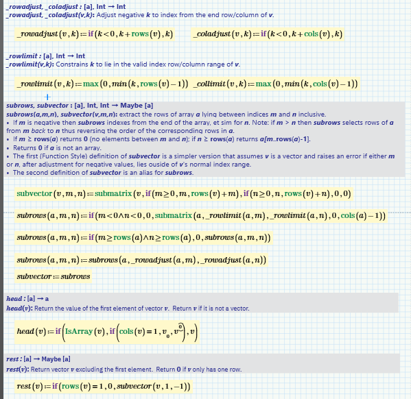

Here's a version of filterNaN for those of you with only Mathcad Express.
Application of filterNaN to DATA from CSV file:
Here are the other functions used in the making of the filterNaN reboot.
Note that the new function will only process about 4,500 rows before running into Mathcad's recursion depth limit, but it should be simple enough to break a larger array into pieces, process them and join up the filtered pieces.
