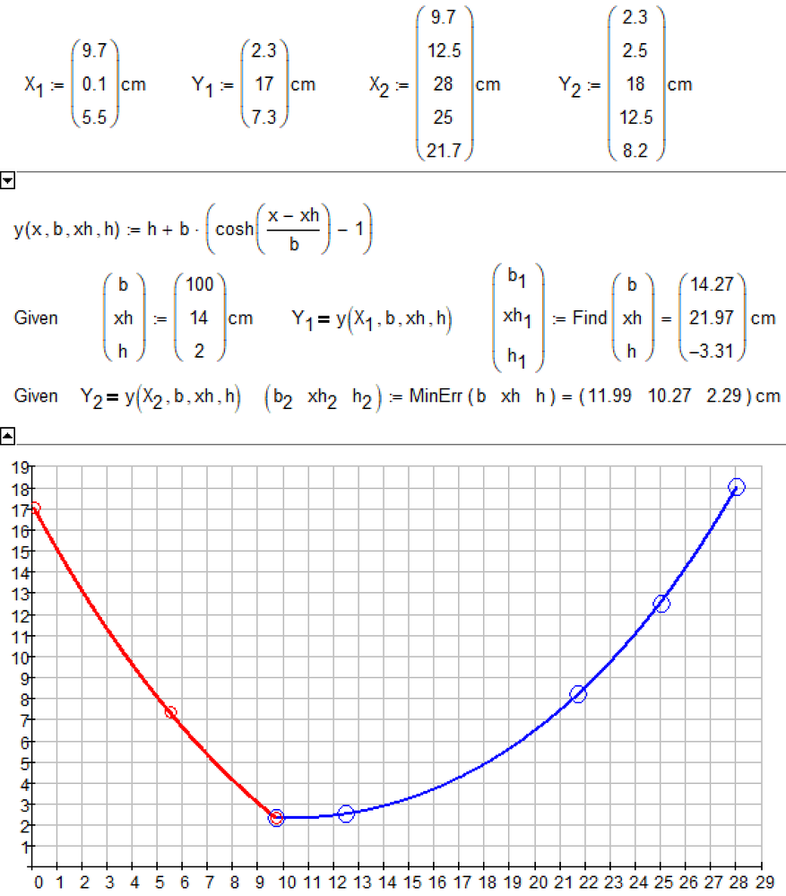

We can use (only in Mathcad 15 not in Prime) a vector or a matrix with one row as an argument of the Find (MinErr, Minimize and Maximize) function.
One example
6 REPLIES 6
The problem
PS
I have called Find and MinError functions as a prefix operator!

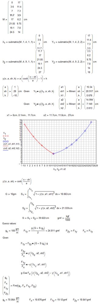

PS
Solution without animation is not solution
Sorry, more correct (fine) picture

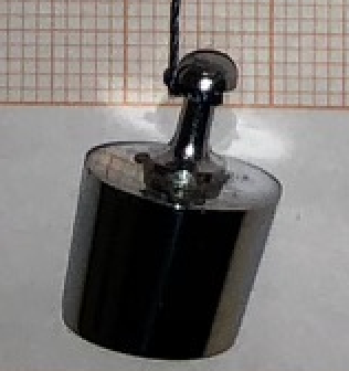

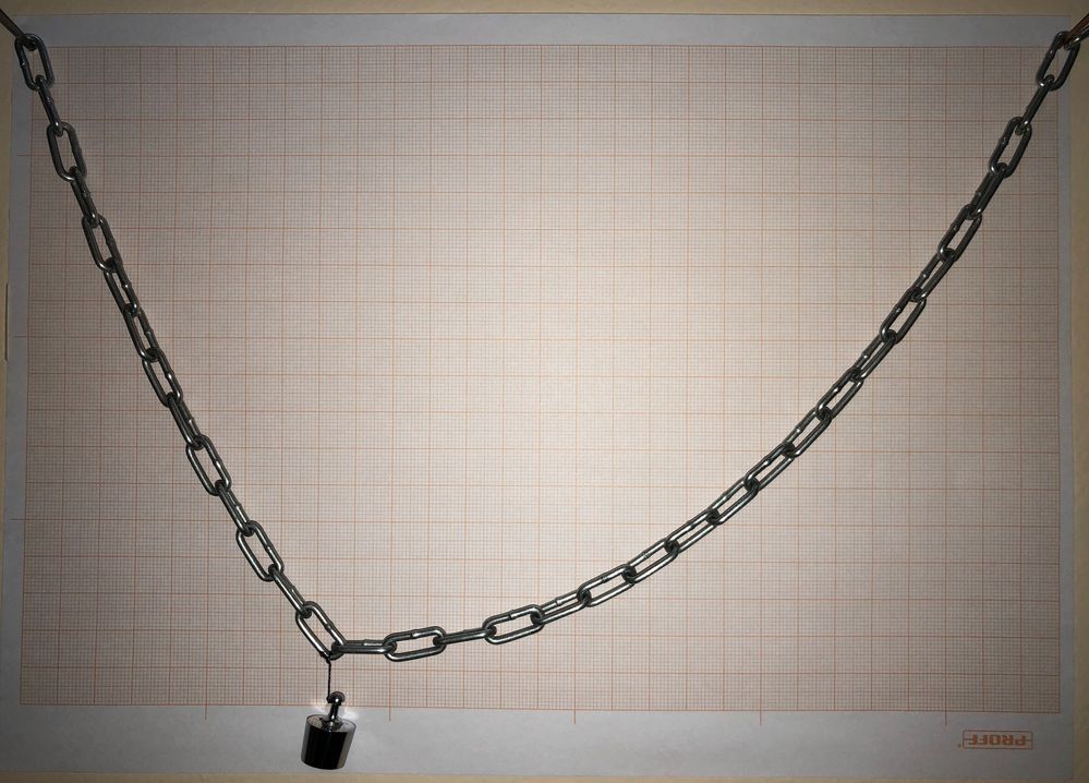

It is one interesting idea to search Mathcad thru Physic
What is it?
A holy load?
