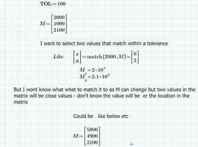

HI Help with finding matching values:

Thank you for that. How can I also choose one that does not match?

What I meant was:
muser_0-1634506417505.png Select 1000
select 4000

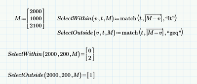

Like this?

Elegant!
