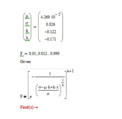

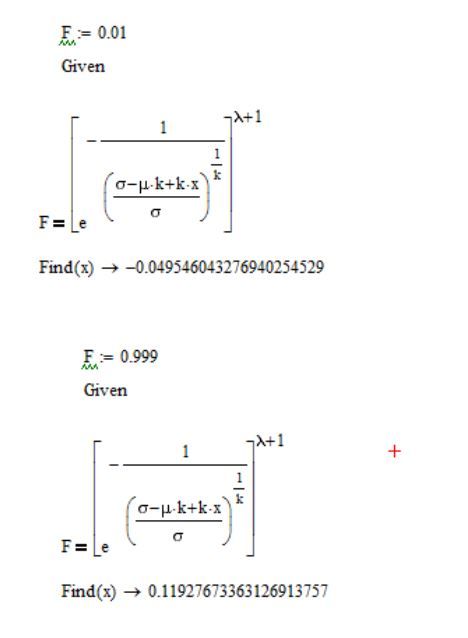

Hello there,
I have a problem to get multiple answers from this equation,
 kindly refer attached file for the problem. thanks in advanced

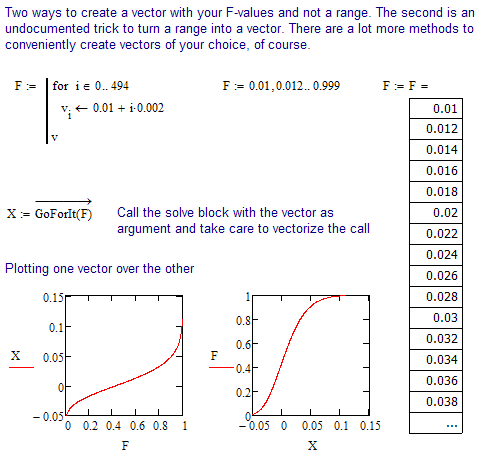

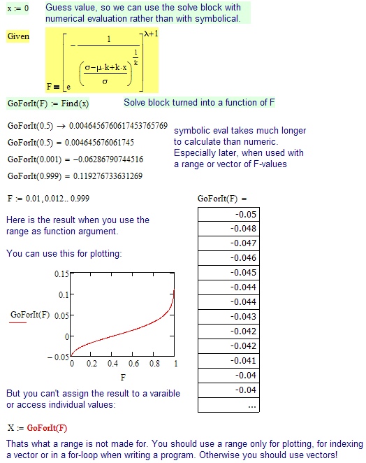

The attached sheet should help!
Be aware of the differences between ranges and vectors!

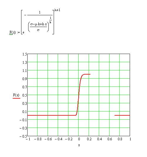

There are a lot of solutions (about 490).
What do you intend to do?
with 0.214<x<0.704 we have complex F.
P.S.: I just realize to my pleasure that the browser spell checker is now enabled even in rich text mode! Hooray!
 Hooray! Guys, I really appreciate your time and effort, and thanks to WernerExinger, you are the best
