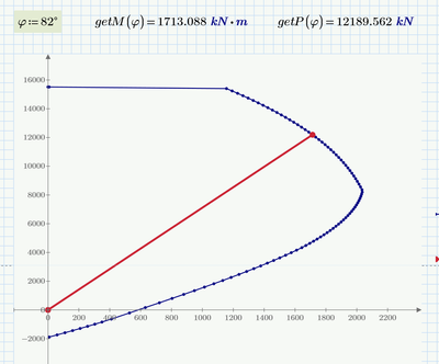

I have the following boundary and an angle with the origin
Pr and Mr are 1 x n vectors. I need to find, by interpolation, what is the value of Pr and Mr that correspond to the angle. what is the easiest way to do that on Mathcad?
I am using Mathcad prime 9.0.0.0. Attached the file

One way I can think of is to calculate a vector Phi with all angles corresponding to all points (M;P).
Then you can create two interpolating functions (may linear interpolation with "linterp") M(phi) and P(phi) using the vectors Phi and M , and Phi and P respective. Now you would have functions which return M and P values for any given angle phi.

OK, when you talk about the angle you have to be aware that this angle is dependent on the units the quantities are displayed in.
Should a point like #10 M=1423.44 kNm, P=14074.94 kN correspond to the angle 84.225 ° ??
It won't look that way in the plot because different scales are used on both axis:
Here is the solution given the assumptions made in my previous reply.
Prime 9 sheet attached
That is right, the results would be dependent on the unit
as you assumed below, using kN and kN.m is ok, since I just need to compare the values of a point (Mr, Pr) passing through that angle with the values of Mr, Pr at the boundary.
