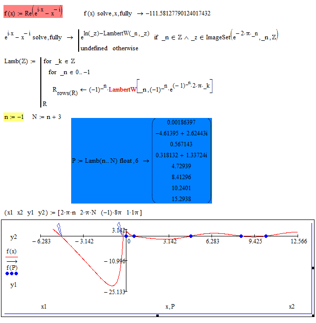

Now I have the relative and similar question :
How to make a correction to my guessing-program-function for finding two more solutions in this range ?
Best Regards.

As help, the internet, and Werner have shown, the Lambert W function has two branches.  What does Lamb(0,4) give you for zeros?

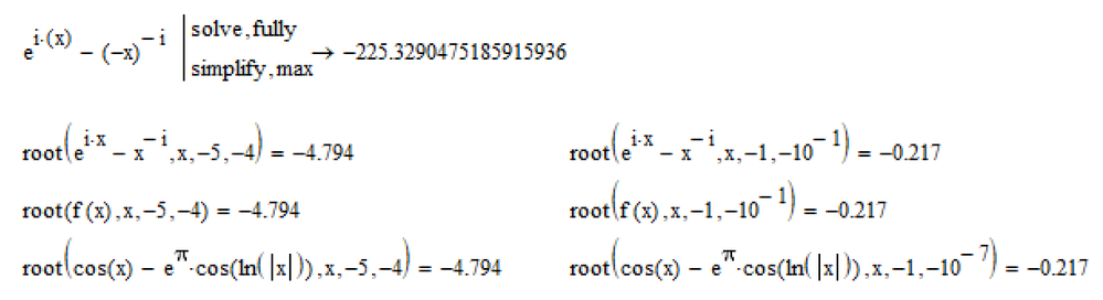

(To:lvl107)
Once again you define a function f(x) which describes a whole family of curves, not just one.
The numerics pic a different member of this family when x is negative, but the symbolics only solves one member of the family where you only get real results for x>0.
The get the solutions you are looking for you would have to try to solve a different equation (x -> -x), but you already had a very similar example and have already seen that Mathcad/MuPad is not able to solve symbolically.
So again what remains is to use the numerics.
