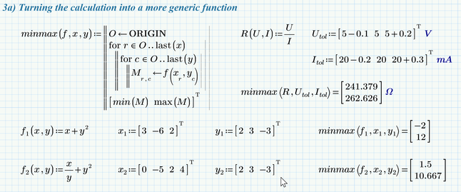

I've been scouring the forums for a while now and I'm starting to come to the conclusion that either my question is so simple that nobody else needs to ask how to do it or that it just can't be done. Put simply, I'm trying to find out how I can get MathCAD (using Prime 4.0) to return the highest or lowest result of a function given a list of possible input variables.
For example, if I have a simple function:
f(x,y) = x + y^2
and a list of possible values for x and y:
x = [3, -6, 2] y = [2, 3, -3]
How can I get MathCAD to output the largest (11) or smallest (-2) result?
Solved! Go to Solution.
Here are a few ways to do it
But I would prefer to write a utility function to do the job

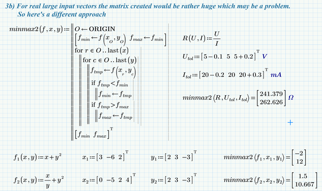

Sometimes it may be a problem to have the function create the full matrix, so a different, a little bit more lengthy approach would do the same job:
Worksheet in format P4 attached

That is probably the most thorough and well-documented answer I've ever received! Thank you so much!
In the 2nd line in your 1st screenshot, why is there a "T" superscript on the bracketed numbers for x and y
That 'superscript T' is the transpose operator.
It turns a row vector into a column vector:
a column vector into a row vector:
and exchanges rows and columns in a matrix:
Luc already explained the meaning of the transpose operator.
The question about the "why" I used it is simply answered: To save vertical space. It makes the worksheet looking a bit cleaner when a column vector is defined as a transposed row vector 😉
The same goes for the evaluation/display of a vector. Often its preferable to display it transposed in a row rather then the vector display taking up multiple lines in the text.
