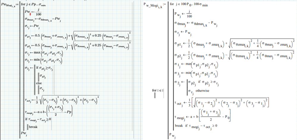

I have a task to make the code in the left as written in the right but I have an error as attached appreciate if anyone can help.

Only change j to integer.

Look carefully at the error message that Prime gives: "This value must be an integer"
Pw is a vector. You are using j to index into that vector, that means you are trying to point to one element of that vector. Then j must be an integer, a whole number, in the range 0, 1, 2, ...., and it cannot have units.
Now look at how you defined j: it runs from Pp ( a few million Pascals) to sigma (I don't even want to know what that is.)
If you have to recreate the Mathcad file into Prime, be careful about what you change...
