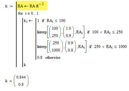

Attached is a copy of Mathcad file for Wind load for gable structure. The function is turned "Red" and I do not know how to trouble shoot the problem. Please see if any one can help.

Move the highlighted assignment in front of the for-loop. Otherwise  RA is assigned he dimension "per area" the second time the loops runs.

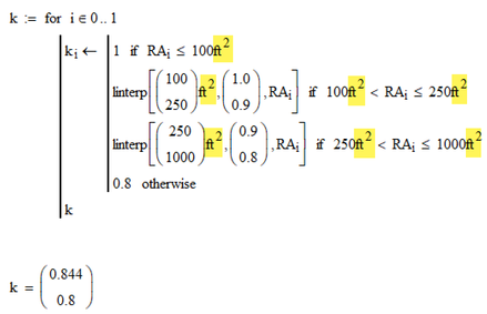

BTW, you don't need to strip the units from RA if you add them in your program at the correct places:

It could also go like this:

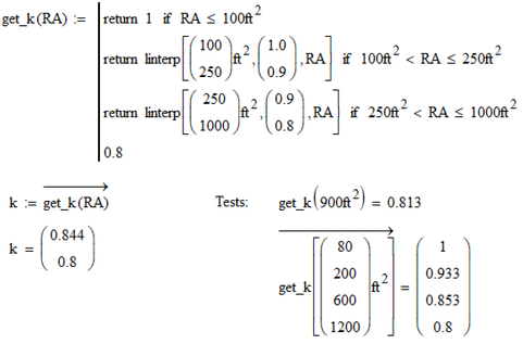

Too much cluttered IMHO. And why variable k0?
After all I'd prefer using a function which later is called vectorized.
And to avoid the nested if..otherwise statements (which aren't necessary because of the special way Mathcad interprets successive if-statements) I'd prefer using return statements to quit the program as soon as possible:

Wonderful!!! However I have always done so.
