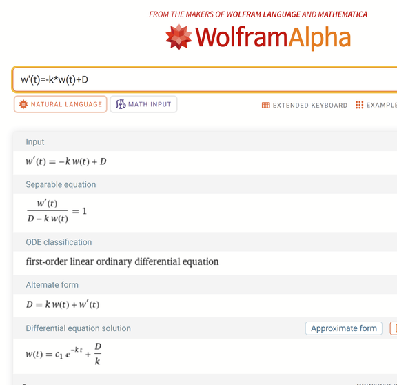

BTW, even though it doesn't mean anything, the solution of Wolfram Alpha also uses the same sign convention

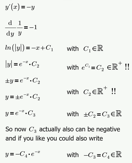

Here the integration of the simple ODE y'=-y in more detail.
Many people don't do it that way, though, because they (hopefully) know that at the end the constant is allowed to be any sign.
But this actually is only true because of the absolute value you get when you integrate 1/y.
