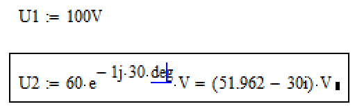

Do not use j:=sqrt(-1) - use not j but 1j or 1i by input a complex number!
And 3-d
Ok, big thx for help 🙂 .
You welcome!

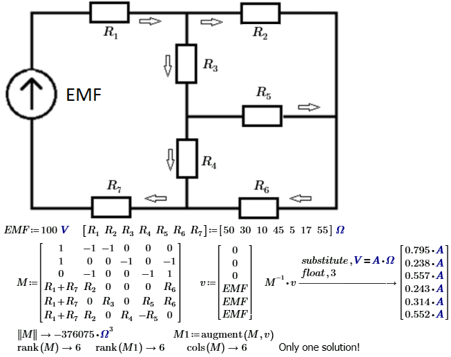

I think better use for this task Mathcad Prime.
Why?
1 Prime has new format for complex number
2. We can use in Prime differenf units in vectors and matrixes.
One example
