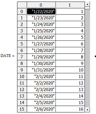

Three files are attached:
DATE.csv
DATA.csv
DATE.xmcd

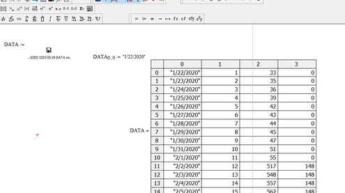

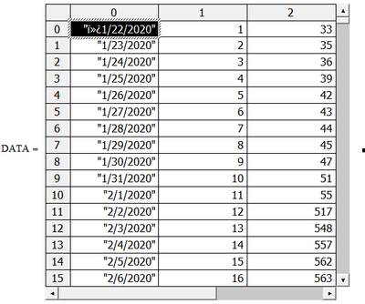

When reading the two csv files into the Mathcad file, the first element of the DATA file is corrupted and looks like

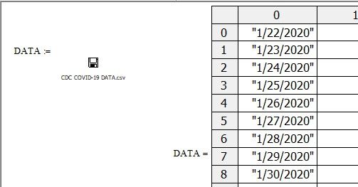

However, the DATE.csv file reads in correctly as:
What is causing the corrupted first element when reading in the DATA.csv file.

Retyped the date that is first entry in the data file and this eliminated the three rogue characters.

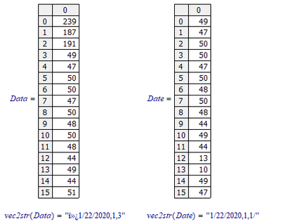

Your problem occurs because there is actually some data in front of the first date, in the DATA file.
I read the first 16 bytes of each file to show:
Note that 49 is the ASCII character "1", that's where the date starts.
Whatever you used to generate those .CSV files, has put those extra bytes with values 239, 187 and 191 in front of the first date.

I downloaded the two .CSV files that you attached at the start of this thread. Opened them with Notepad, to see nothing wrong apparently.
Then I started Mathcad and used READBIN() to take the first 16 bytes out of each of the two files and display the data values.
The extra bytes at the start are in that one .CSV file, as shown in my previous reaction. I opened the same file using Excel, and it also starts with the date, showing no signs of extra characters. Apparently these characters don't show normally.
I guess, if you want to 'repair' the DATA file using Notepad, you'll have to copy the entire data set (the 'text' in Notepad), and paste it to a new (Notepad) file, which you can save under the same (overwrite), or a new file name.

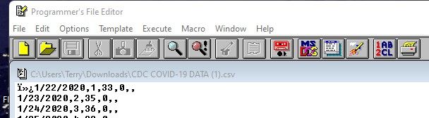

I used an old program called "Programmer's File Editor" .
Program shows up spurious characters in files.so you can delete them.
Program is freeware and has proved useful to me a number of times.

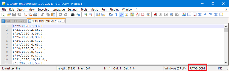

I did not read all replies ... so I am not sure whether following information is new for you.
I opened both csv files in Notepad++.
DATE FILE.csv ... file format is UTF-8
CDC COVID-19 DATA.csv ... file format is UTF-8-BOM ... this explains 3 "invisible" characters at the beginning of the file
CDC COVID-19 DATA.csv ... file size = 31 239 bytes
SOLUTION
In Notepad++
  • create new file
  • select the entire contents of the file CDC COVID-19 DATA.csv using CTRL+A
  • copy selection into clipboard using CTRL+C
  • copy clipboard contents into new file using CTRL+V
  • save new file as new CDC COVID-19 DATA.csv
  • new CDC COVID-19 DATA.csv ... file format = UTF-8 ... files size = 31 236 bytes (3 "invisible" characters were removed)
  • import new CDC COVID-19 DATA.csv into Mathcad
Martin Hanák
