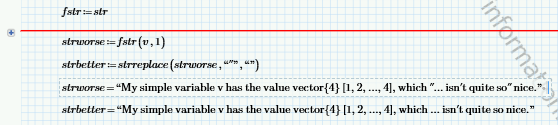

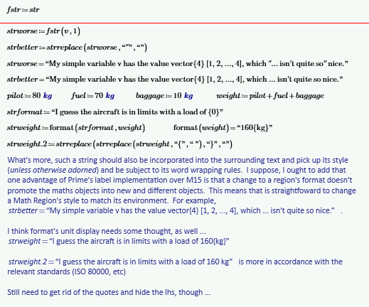

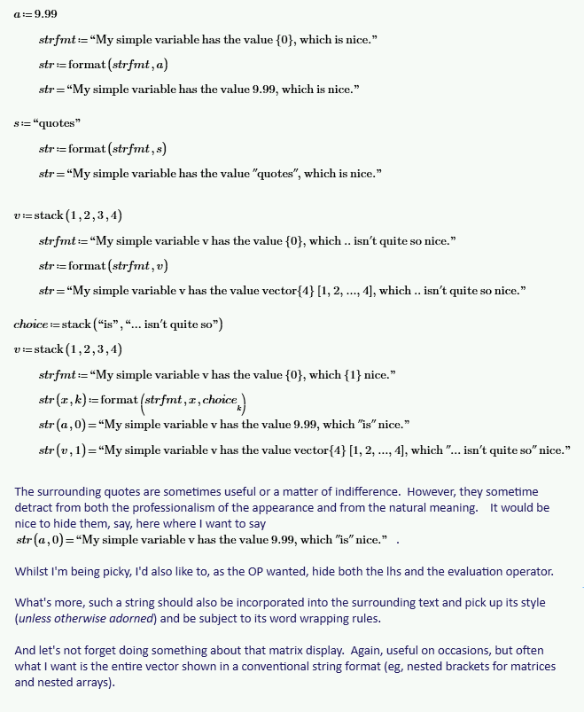

(I sometimes use the format function to do what you are requesting, but the display of strings makes it look "ugly" - which is often fine, but sometimes quite annoying to look at, as this Mathcad Express 7 worksheet attempts to show:

What I would like to do is, in Stuart's example, is omit the str(a,0)= and only include the "my simple variable v has the value 9.99, which "is" nice". That way you can include results naturally in a text field without the somewhat distracting variable name. I think this was possible a couple of different ways in 15.

(I sometimes use the format function to do what you are requesting, but the display of strings makes it look "ugly" - which is often fine, but sometimes quite annoying to look at, as this Mathcad Express 7 worksheet attempts to show:)
Forgot to add that the internal quotes are fairly easy to get rid of if you're willing to roll your own string replacement function
Stuart
