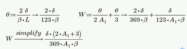

1) Follow each assignment which may throw a numerical error by a symbolic evaluation. Drawback is that the assigned expression now is shown twice
Already defined variables are replaced by their actual values unless you use the modifier "explicit" like

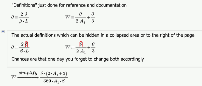

You could use the Boolean equal for documentation and the actual assignments which throw the errors may be hidden in a collapsed area or to the right of the right margin where they are not printed.

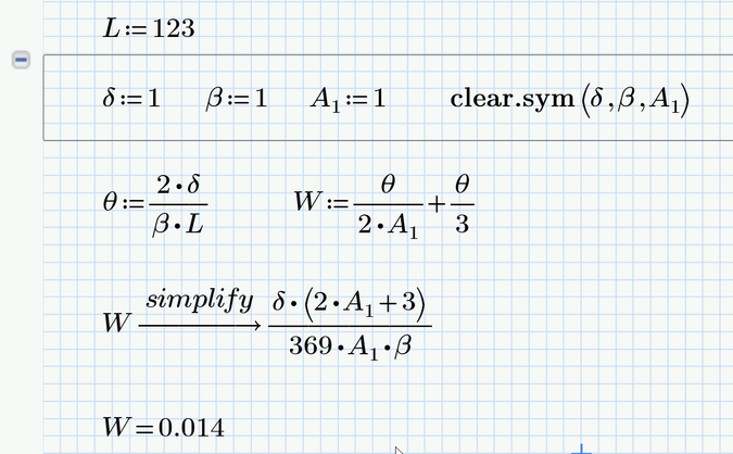

You define all variables with dummy values and then clear them, but just for symbolic use. You can again hide the variable definitions in a collapsed region or to the far right.
The numeric evaluation in the last line shows that the variables have kept their numeric value for numeric calculations which is the reason why the numeric engine isn't throwing any errors.

The third solution works for me
luckily it is not a very long file so it's easy to adjust!
thank you
