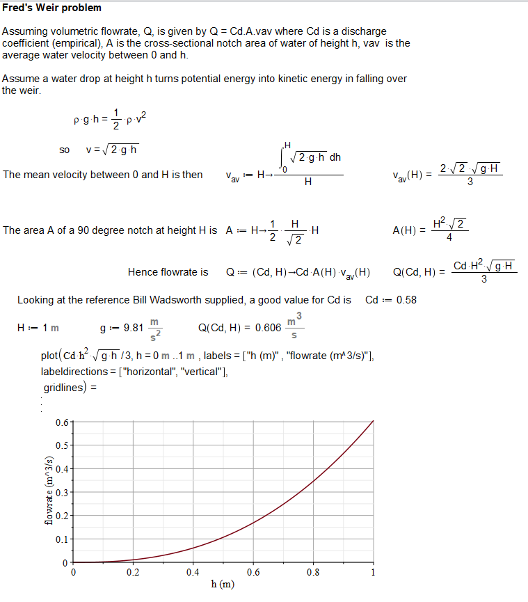

I thought it would be interesting to do a side by side comparison of a relatively simple calculation, so I've compared my response to Fred's question about a weir -  see below.
I didn't use units in Maple flow as I couldn't get the plot to work properly with them, though the individual calculations worked ok with them (it's likely that a more experienced Maple flow user would be able to get the plot done with units).  There are some syntax differences as might be expected - the above shows a difference in the way functions are defined.
At present I find Mathcad easier to use -  but I've been using Mathcad for over 20 years, while I've been using Maple flow for one day!

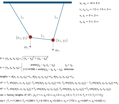

Maple flow as above, but with symbolics and units:

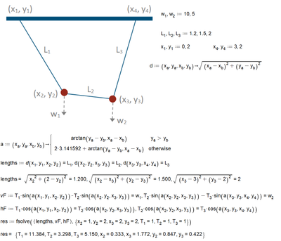

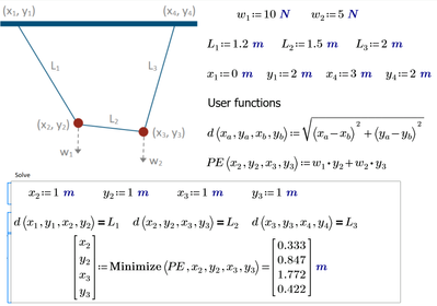

My comparation (with and without units).
PositionofTwoObjectsSuspendedandConnectedbyRopes-Mathcad.pngPositionofTwoObjectsSuspendedandConnectedbyRopes-Maple.png
With units

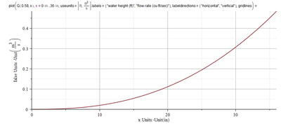

Encouraged by Alan, I've been playing with Mapleflow.  Since a lot of my effort required units and since there appeared to be an issue with units on plots, I've spent most of my time there.
  • While Maple has commands to add a unit to the list, it doesn't look like 'flow can;  the command doesn't throw an error, but it has no effect.  (I have not been able to create a unit for "g," one unit gravity at earth's surface.  We often measure acceleration in g's)

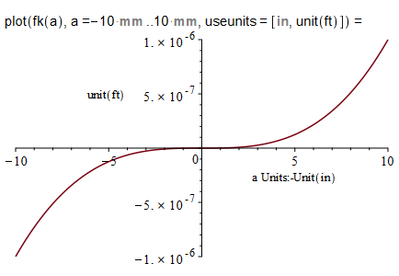

  • Units in plots works sometimes, but the effect is not consistent or predictable:Fred_Kohlhepp_0-1623506854932.png
    (Note that (I believe) the vertical axis is correct, but the horizontal axis is not.)  This one is wrong completely
I like Mathcad because I don't (often) need to develop long scripted strings in unyielding programming language.  Mapleflow seems to be an abbreviated front end to Maple, not the white board it claims to be.
Needs work!
