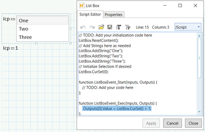

Hello. Quite new to Prime 10.
How do I set Icp, to output "One", rather than enum value of 1? I am guessing I have to modify the highlighted script shown, but not quite sure how. thanks so much for your help.

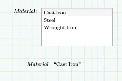

Like This:
Thanks so much. That works. I see that you use VBscript. Anyone know the link to the document for VBscripting for Mathcad 10? Thanks so much.
