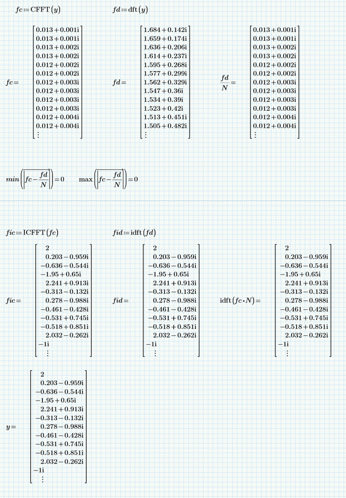

I am using CFFT for calculations in Mathcad 14. Mathcad Prime 10 recommends using dtf rather than CFFT.
However, CFFT and dft have different scaling.
Could you tell me how to change the program to change from CFFT to dft and get the same calculation results?

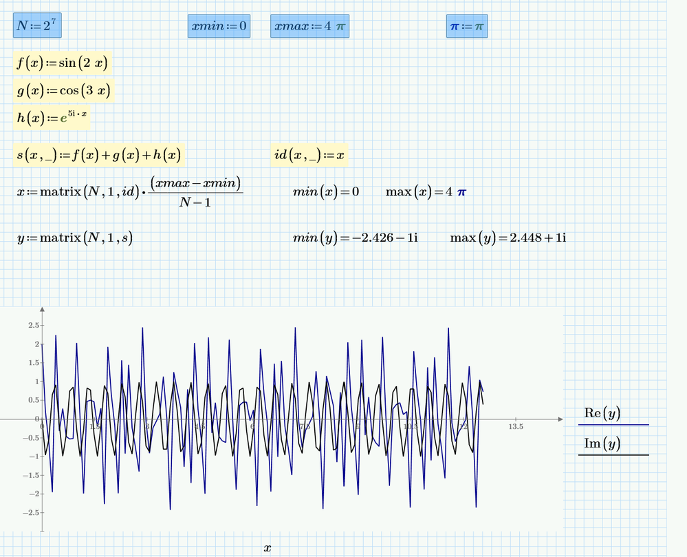

(Divide dft results by the number of samples) to convert to CFFT results.
Take the idft of the (CFFT multiplied by the number of samples).

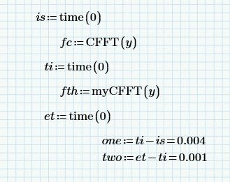

Hi just wanted to share this.
I have used a C++ FFT library called fftw3 and have written a custom DLL function that can be called from Prime.  Custom function is called myCFFT and takes a complex array as input and returns a complex array as output.  Using Stuart's sheet and definition of y as a 128 value sequence get the following timings. myCFFT running in  C++ is four times as fast as the Prime function.  There is calling overhead in the myCFFT function meaning time is gained for larger sequences and repeated CFFT's
This means it is possible with larger sequences and multiple sequences a large increase in speed for the OP's previous post is possible.  Will work on this over the next few days.
Cheers
Terry
