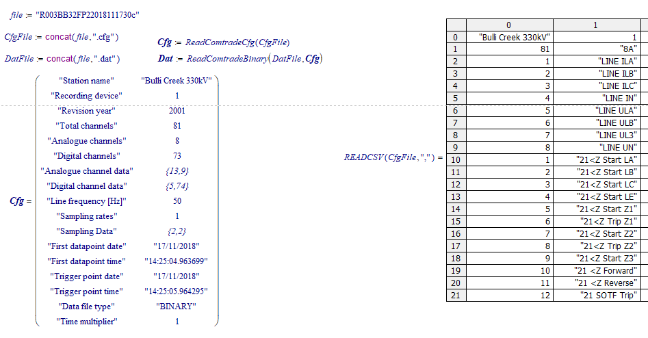

There was an(other) error in the ReadComtradeCfg function.
It's corrected now, and I've changed the Prime (4) version to use the built-in READCSV function.
Now both implementations (Mathcad 11 and up, as well as Prime 4 and up) should be able to read both data sets.

I am trying this with the following files (attached). (Page 5)  Based on the file you created.
I can get the Ia value as I expect,
I think the Ib should be 39.286, 95.7063,127.58 etc
Similarly Ic= -126.778,-133.204,-125609
The voltages
Va=270618,23169,168359 etc
Vb=-70.841,18666.5,108174,etc
Vc=-199898,-25.1208,-276949 etc
What am I doing wrong?

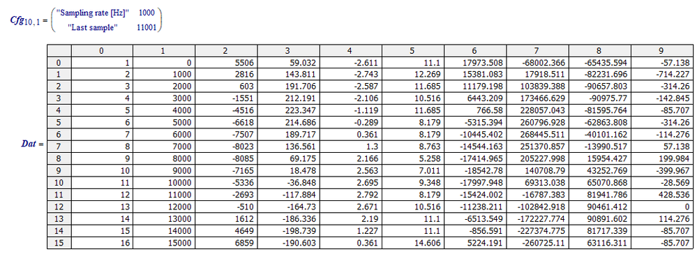

Any way. I got these results from your file set:
So there are 8 analog channels, 4 with current and 4 with voltage.
And the data is:
ILA is in column 2, ILB is in colum 3...ULA is in column 6 etc.
From your info I gather that you get ILA as 5506, 2816 etc. What makes you think that ILB should be other than 59.05, 143.829 etc. ?

Hmm, found one error. In the last statement of the ReadComtradeBinary function. You should correct as follows:
The 'multiplier' is added, instead of the 'adder', but that should not make (such) a big difference in ILB.
Now the analog data reads:

Found it. The for loop should read:
I had double ORIGIN. But worse: I had a too high offset, 2 instead of 1.
Anyway that's now corrected. The data now reads:
(There's your 39.286 for ILB ).
Attached is a corrected Prime 4 file.

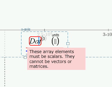

(To:LucMeekes)
Hi Luc
I tried to use the file that you did for Ana bit I got an error in the plot. My Mathcad skills are not too flash. Would you be able to comment if you have the time? I am attaching the Comtrade files that I have been using
