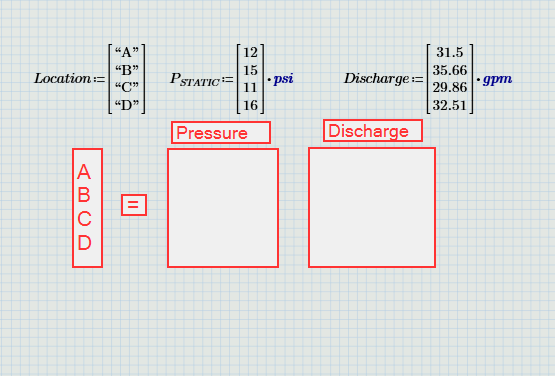

I need to add a summary at thr bottom of my calculation to shoe results as shown below.
I am not able to do.
I request shed me with some lights to get around this.

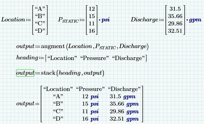

However, sometimes it is useful to have a generic function to create tables.
The last table example in the image below separates the Location from the pressure and discharge data.

One way is to create a matrix.
Cheers
Terry

Terry's solution is ideal for your particular case.
Stuart
(Mathcad 10 worksheet attached)
