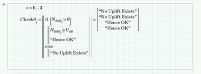

Hi guys,
I'm pretty new in mathcad and I really need your help.
I have a vector and I want to check each member of it, if it is negative or positive. If it is negative, I want to compare it with a value but if it is positive I want the program to stop.
Please see attached
Cheers,

I can't read Prime7 files. Are you looking for something like this:
yes, something like this but I don't want the results in a vector. Just a small program that if a condition is satisfied the program to return a value a otherwise to return a value b.

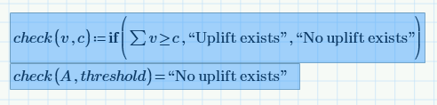

Hi Luc,
The second solution actually works but the issue is that I don't want this to return a vector. I just want to check all the values and either write "OK" or write "Uplift doesn't exist''. Can this be done?
So actually, to choose only the values of the vector that are positive and check these. If there are no such values to return no uplift exists, not sure I have confused you more

If I understand correctly:
and gives:
or:
Gives:
And with a different check value (after all: small and large are relative concepts):
Thanks Luk,
That  works great! attached the worksheet

Do you mean something like this?

Maybe it should be
Maybe this variant is preferred
Lets wait for the OP to answer and clarify

Yes, the parentheses do clarify where the comparison lies.
Indeed.  I'm not sure exactly what is wanted.
