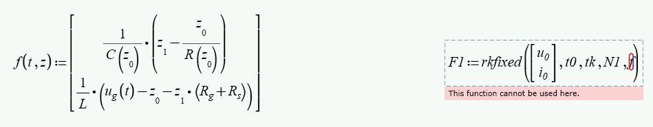

The file is from Mathsoft MathCad, but I want to run it in the new PTC MathCad what is the solution please answer ASAP.
Enclosed is converted file to Prime 7.
There is a problem with rkfixed function used in the Prime worksheet.

Which version of 'the new Mathcad' Prime do you have/want to use.
If it is version 7, you should be able to convert it with the built-in converter.
If it's an older version 1...6, you need to have Mathcad 15 installed in parallel, on the same computer, to do the conversion....
