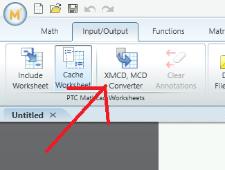

Azri
(To:LucMeekes)
Hi Luc,
can you help me convert this old mathcad .xmcd file to into .mcdx
I dont have older version Mathcad

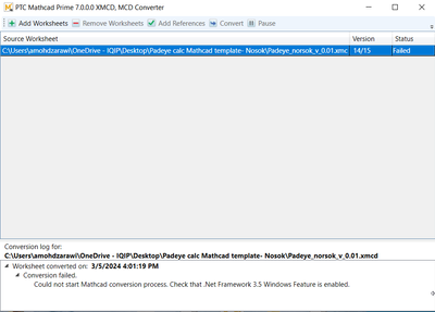

Azri
(To:LucMeekes)
I have Prime 7.0
Yes I have the converter, but when i try to convert the file, it failed to converts. see error as in the figure below,
can you help me with this?
I am not authorized to install other tool in my office pc as it is not allow by my company policy.

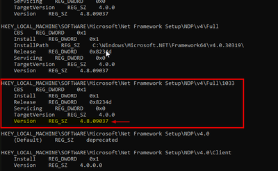

Azri
VladimirN
(To:Azri)
From "Hardware Notes – PTC Mathcad Prime 7.0.0.0" ( https://www.ptc.com/en/support/refdoc/Mathcad_Prime/7.0/Mathcad_Prime_7_0_platform_support )
Azri
(To:VladimirN)
This is my current .NET Framework version 😅
LucMeekes
(To:Azri)
Appears like you do have .Net 4.8 installed on your PC.    and,
According to Microsoft information 4.8 should cover/replace 4.7.2.
I suppose you contact PTC support and:
- have them help you, or,
- complain that their software is lying to you.

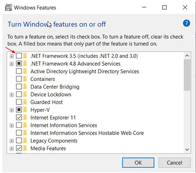

Azri
(To:LucMeekes)
I have found the solution to my issue 😁
For my windows 10, I need to tick to enable .NET Framework 3.5.
.NET Framework 3.5 might be disabled on default for my pc. The conversion was successful when I enable this option.
I followed this step to enable the .NET Framework 3.5 : https://success.panaya.com/docs/how-to-verify-net-35-is-enabled
Cheers!
