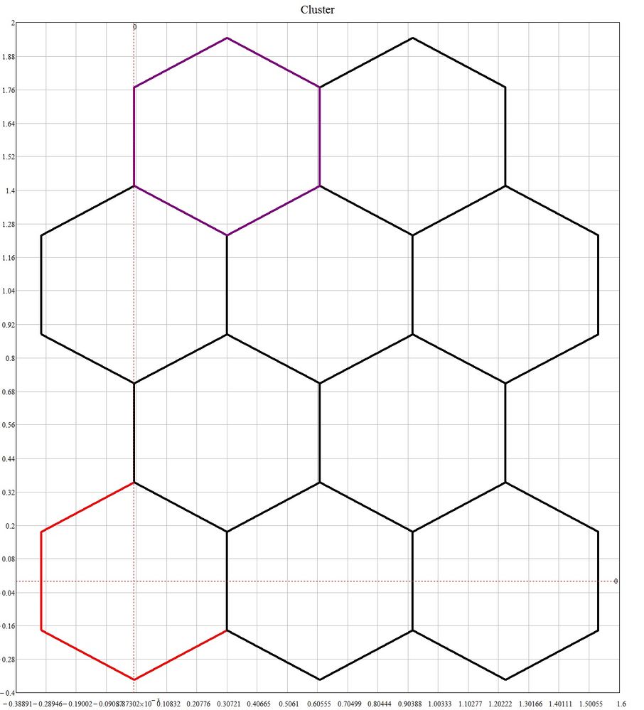

For example i have deployed some random nodes in (200x200), but the problem is i want to form some random cluster's, like the given graph, please look my mathcad file !

you want something like that expandable as you like. right? in GSM networks, for example, the hexagons are all the same size and adjacent. To the chart, must be added the random positions of the sources, while the antennas are in the vertices. It's been a long time since I've dealt with the subject.
I'm working on it

Thank for reply, Yes the same!

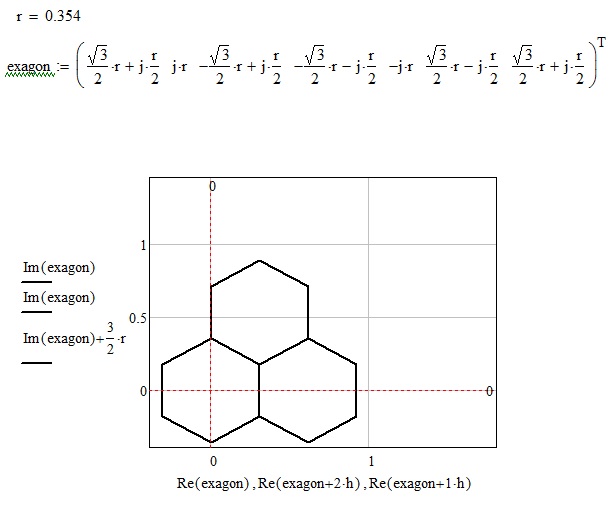

Basically you should work in the complex plan. See the following example. I leave you to continue. I do not go further.

Clustering a plane with hexagons is quite easy but sorting the nodes and assigning each node to a specific cluster od counting the nodes in each cluster can be quite demanding, given that you want a hexagonal area and not a simple rectangle or even square which would make the task much simpler.
There sure are some clever algorithms to determine if a point is inside a given polygon and it may be even simpler in your case as you have regular hexagons.
Furthermore you would have to define what the count should if a point is exactly on a border between two hexagons or is one of the corners belonging to three hexagons.
If you are happy with an approximation you could simply count the nodes within the circumcircle of a hexagon.

For whatever its worth here is a crude way to create a hex grid.
For counting the nodes within a hexagon you might search the forum for a routine a I posted quite a while ago which decides for any polygon if a given point is inside or not. Using a quick search here in the forum did not bring up the thread I have in mind but a routine by Stuart which may serve as well.
