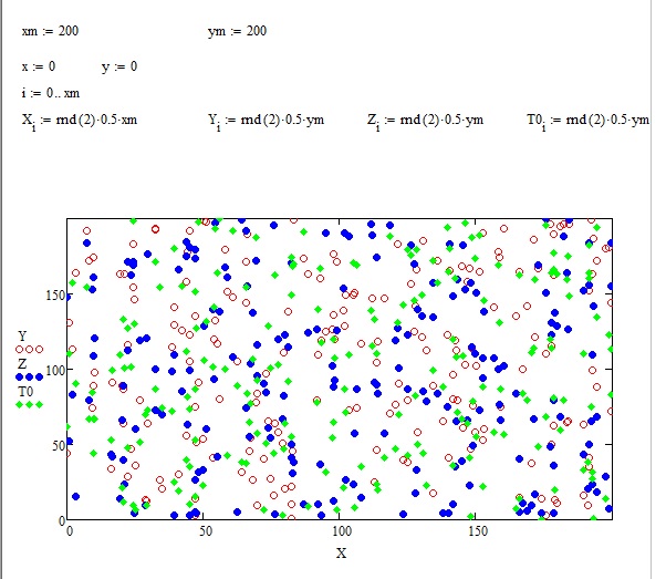

 For example i have deployed some random nodes in (200x200), but the problem is i want to form some random cluster's, like the given graph, please look my mathcad file !

no i not looking for this solution i have attached modified mathcad file please go through it (inform me if have some question regarding it) !
I have modified my mathcad but i don't know how to expand for full block !! please check mathcad file !

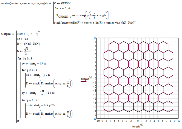

For whatever its worth here is a crude way to create a hex grid.
For counting the nodes within a hexagon you might search the forum for a routine a I posted quite a while ago which decides for any polygon if a given point is inside or not. Using a quick search here in the forum did not bring up the thread I have in mind but a routine by Stuart which may serve as well.

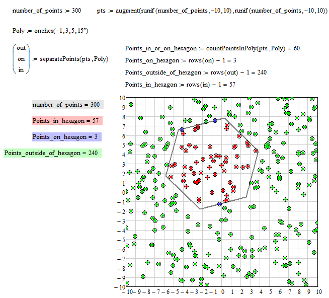

I found a sheet in my archive which compares a couple of different "Point-in-Polygon" algorithms. Its not the routine (based on the Jordan algorithm) I was talking about in my former post but they may serve as well.
I attach the sheet - maybe it can be of use for you.

OK, now I found the Jordan routine I was talking about.
I added it in the attached worksheet along with some routines to scale, rotate and translate the grid
and also included an example how you may use the program to count the number of points in one hexagon:

The routine will give you the number of nodes in any polygon you feed in.
So you will have to decide for a data structure you'd like to manage the various hexagons with.
Clustering a picture with a hexagon structure is one thing, managing that grid as a bunch of individually addressable areas is another. The grid structure I created consists of a list of vertex coordinates separate by a line of NaN's. So you should have not much troubles to split it into a list of single hexagons which you then could feed in the point counting routine. Maybe a vector consisting of elements representing a hexagon each could be a suitable structure. Depends on your needs and what exactly you have in mind.
You still have not decided what to do if a point lies exactly on the border of the polygon.
My routine will not distinguish between point an a segment of the border (belonging to 2 hexagons) and point being a vertex (belonging to 3 hexagons). If thats an issue the Punkt_in_Polygon and some other routines will have to be modified.

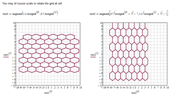

-MFra-
(To:Werner_E)
but, on the hypothesis that the hexagons are regular, why do they deform after rotation?
LucMeekes
(To:-MFra-)
Because, apart from rotating, a different scaling in x- and y- directions is applied...
(To:-MFra-)
I have not shown how to rotate the grid, I just mentioned that it could be done.
What I showed was just different scaling in x- and y-direction - you would expect "deformation" when doing so 😉
Apart from using different scaling factors the difference in the last two plots is that the left one scales wrt the origin and the right one wrt (-7/-7), which therefore remains the center of the lower left hexagon. Just playing around as I not really sure what exactly is needed.
