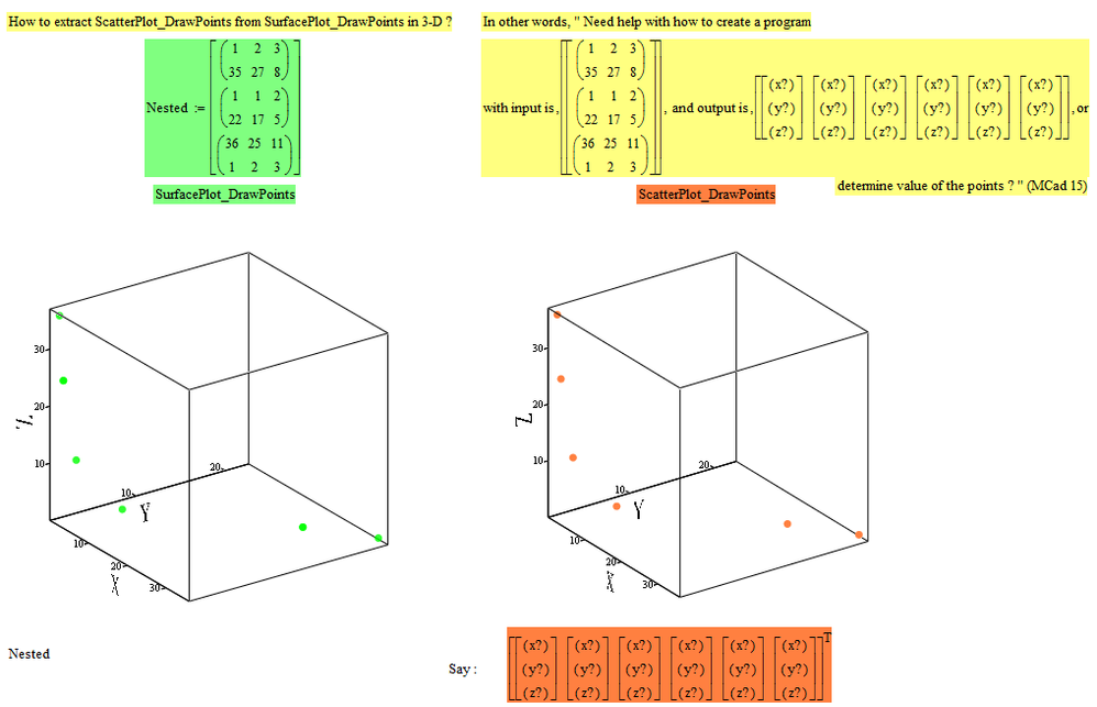

How to extract ScatterPlot from SurfacePlot in 3-D ?
lvl107
20-Turquoise
Hello, Everyone.
From :
Thanks in advance for your time and help.
Best Regards.
Loi

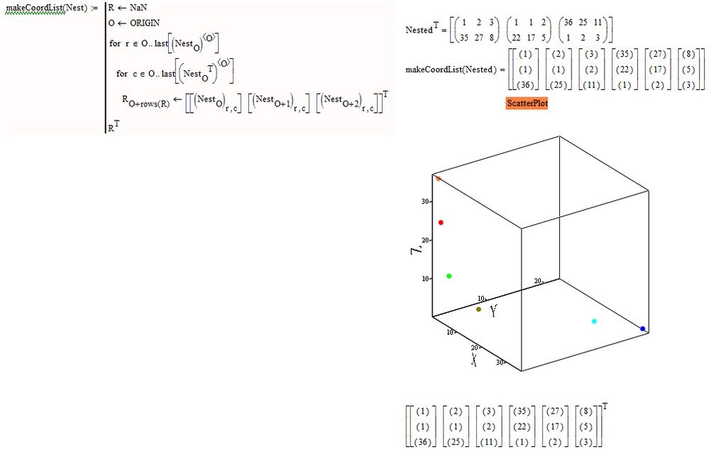

(To:lvl107)
Something like the attached?
2 REPLIES 2
(To:lvl107)
lvl107
20-Turquoise
(To:Werner_E)
Many, many thanks, Werner.
Best Regards.
