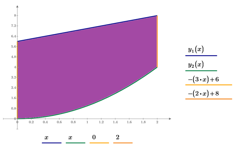

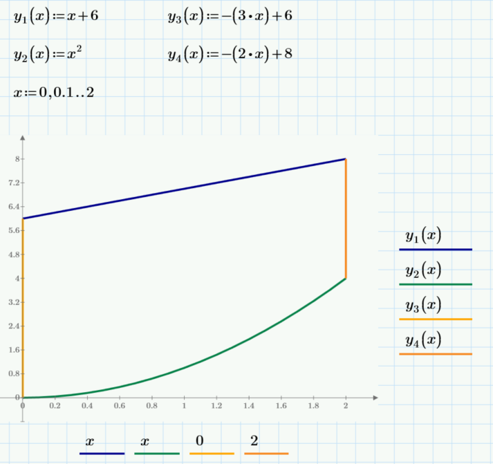

How to fill the below area enclosed between y1(x), y2(x), y3(x), and y4(x), like below with purple?

What you show is NOT the area enclosed by the graphs of these four functions but just the area between y1(x) and y2(x) in the the range 0<x<2.
I consider your way to plot the two orange vertical bars by defining two separate functions y3 and y4 to be very inefficient and uncomfortable. If you would decide to change your range x which you used for plotting, you would have to change these functions as well!!

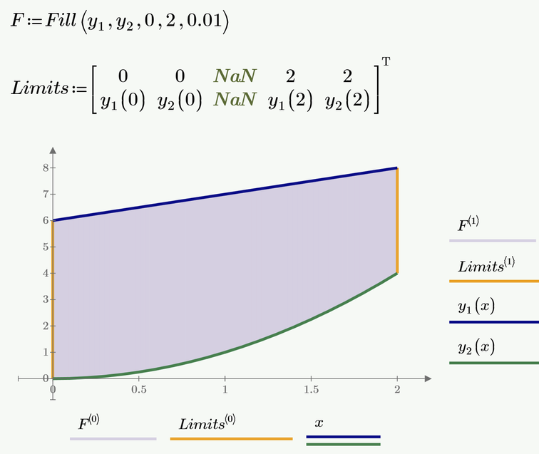

I provided a simple "Fill" function and LucMeekes offered an Express version of it.

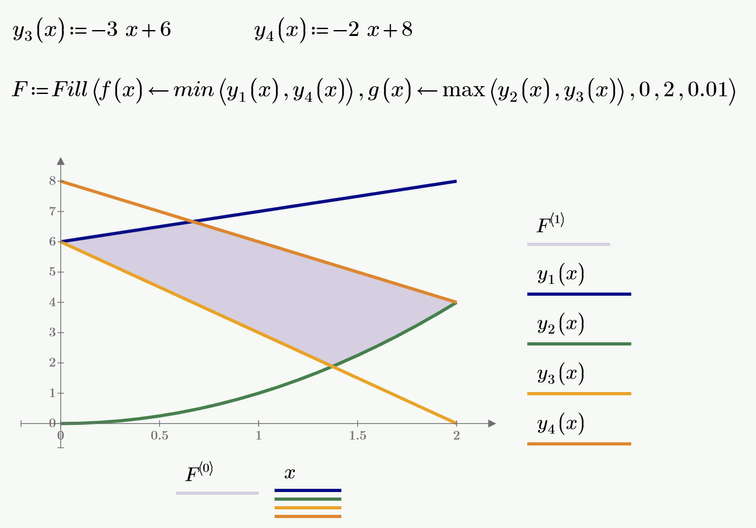

Here your new problem solved using the "Fill" function - no need to define extra functions y3 and y4
And here is a variant that takes your thread title verbatim

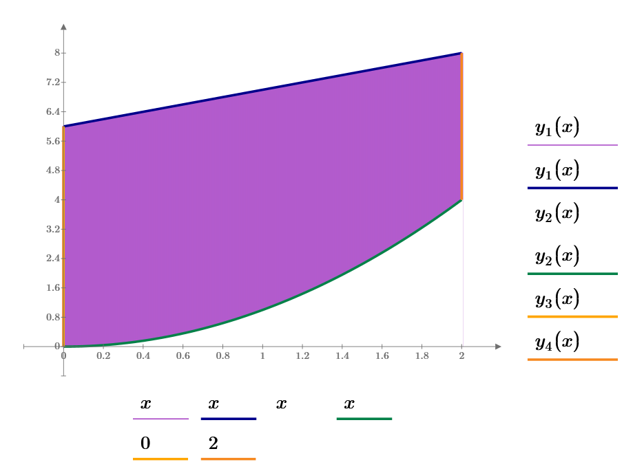

Add same function but bar type before line type.
