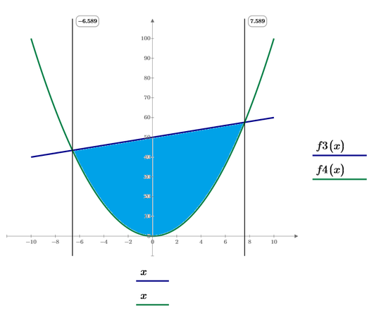

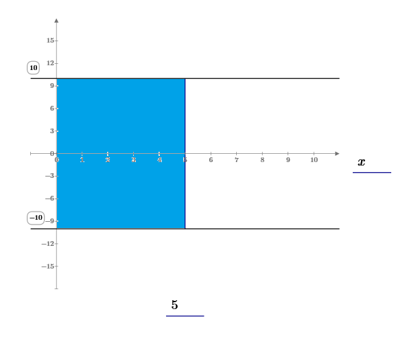

Traces, Change Type, Column Trace.
t.t.

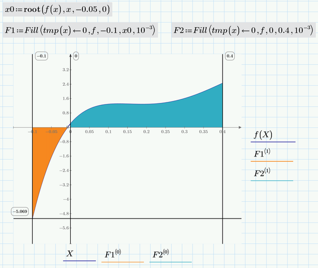

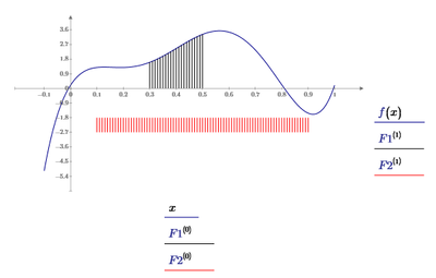

ttokoro21-Topaz IAnswer
Jul 21, 2023 9:33 AM UTC
t.t.

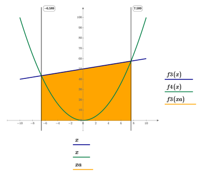

Jul 21, 2023 10:06 AM UTC
Maybe that way
I had not done so, but actually the color fills should be placed in the plot first and only then followed by f(x) and f(X) so these would be on top and visible!

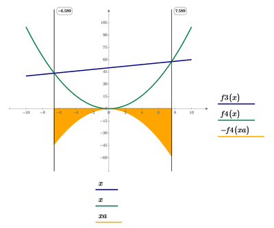

Jul 21, 2023 11:15 AM UTC

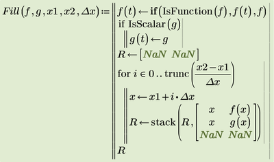

You may wonder, why the usage of Fill() required the argument
This is because my Fill() function is designed to shade the area between the graphs of two functions, not necessarily between the x-axis and one function. So this expression simply is the function for the x-axis.

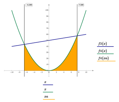

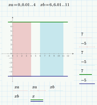

Do you know some similar variant like @ttokoro showed above for shading the area between the x-axis and one graph using xa and xb ranges but now for shading the area between two graphs? Or is it not possible such a variant using some xa/xb ranges for shading the are between the 2 graphs? I mean writing like that: xa = ...., xb = ...., xc= ...., xd = ...., and then plotting these variables with f(xa), f(xb), f(xc), etc, the area between 2 graphs to be colored.

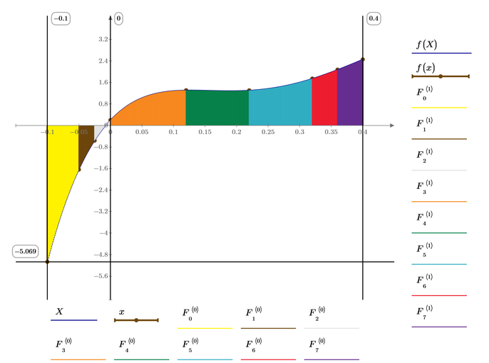

Jul 21, 2023 9:00 PM UTC

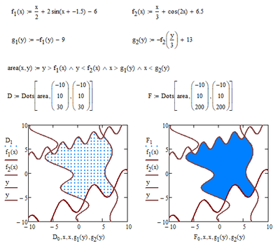

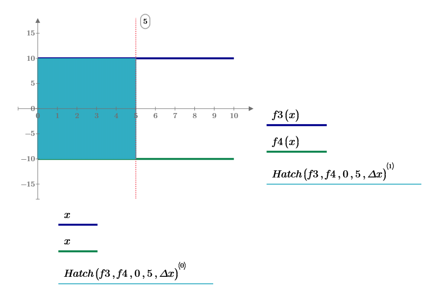

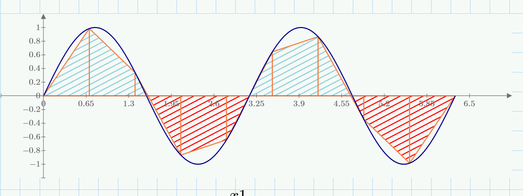

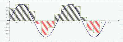

One last remark - if you really want to dig into the depths of shading regions using Primes native plot, you should study the comprehensive 30-page (nothing of value comes easy) worksheet of Prof. Byrge Birkeland.
You may know his outstanding work on "Amazing Images" for real Mathcad:
Here some appetizers from his work on shading areas in Prime:
The attached file stems back from 2013, so I guess its in Prime 2 format.
Have fun!

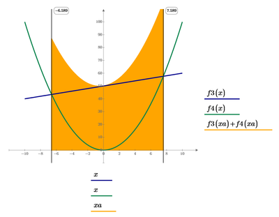

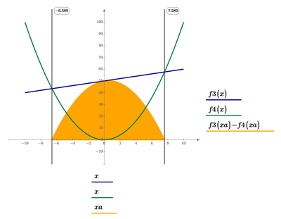

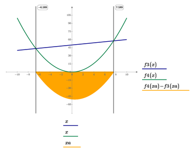

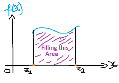

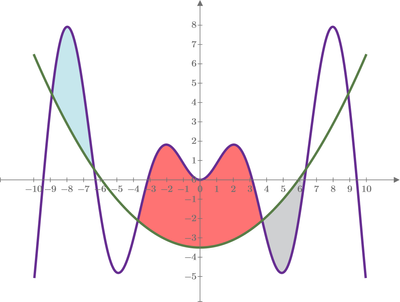

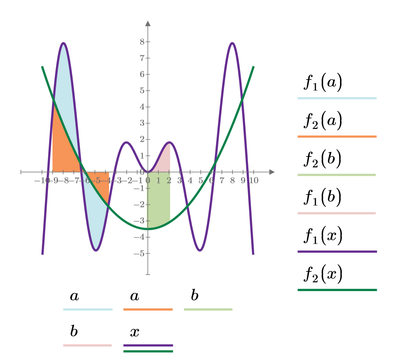

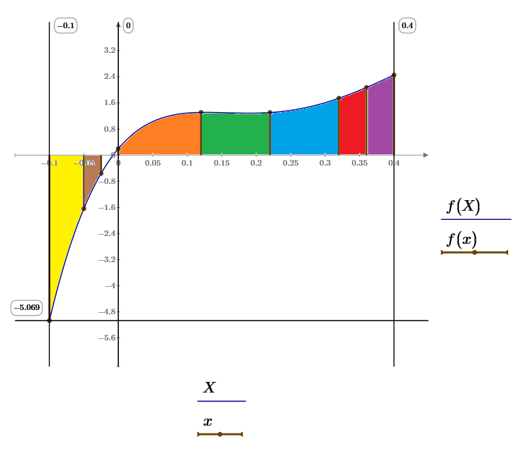

Cornel19-TanzaniteAuthor
Jul 24, 2023 8:36 AM UTC
@LucMeekes @Werner_E @ttokoro
How to do like this?
Cornel_0-1690187926073.pngCornel_1-1690187933255.pngCornel_2-1690187942791.pngCornel_3-1690187949129.png
Mathcad Prime 8 file attached.

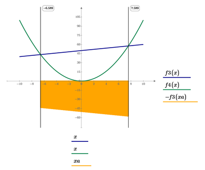

ttokoro
Jul 24, 2023 9:21 AM UTC
Only this plot use a tric. Others are only plot 2 Line Traces and One Column Trace.

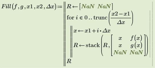

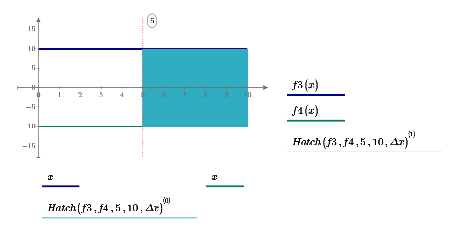

23-Emerald V
Jul 23, 2023 2:38 PM UTC

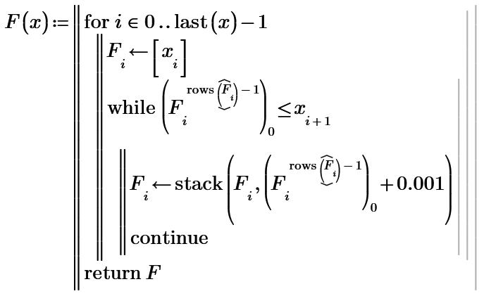

For those limited to express, the following set of functions implement @Werner_E 's Fill() function with the added benefit that it also accepts scalars instead of functions, so the construct "tmp(x)<-0" is not needed:
example:
Prime4 file attached.
23-Emerald V
Jul 26, 2023 9:40 AM UTC
I managed to get Fill() for Prime Express into a single function:

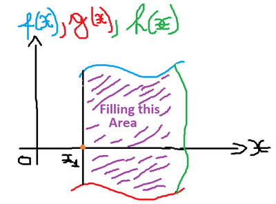

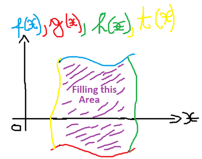

Jul 26, 2023 10:04 AM UTC
So, from my understanding, all above functions that you posted so far are for the following 2 variants:
So, for the variant when someone wants to fill with colour the area between one function f(x), two points given on the x-axis x1 and x2, and x-axis (0 line). or for the variant when someone wants to fill with colour the area between 2 functions f(x) and g(x) and 2 points given on the x-axis x1 and x2.
But when someone wants to fill with colour the area between 3 functions f(x), g(x) and h(x) and only one point given on the x-axis x1 or when someone wants to fill with colour the area between 4 functions f(x), g(x), h(x) and t(x), then is it possible something like that?
