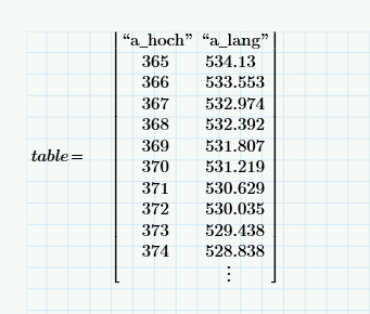

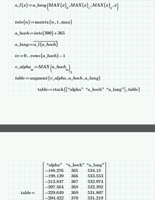

Hello

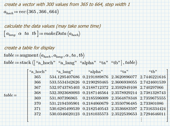

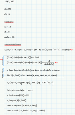

I hope somebody could help me.
I have this function with a table which shows the "a_hoch" and "a_lang" values. I want to show the angle "alpha" as well in this table. How could I do this? Unfortunately I can not upload the file.
Thanks a lot and best regards
Andreas

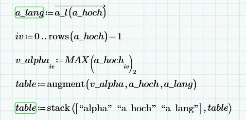

Hi Terry
Sorry I use Prime 7. Tried to implement your formula but get strange alpha values.
Sorry but I can not upload my file.
Could you help me again?

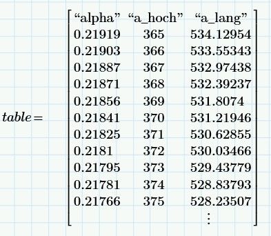

I am confused as your problem seems to be the same as was posted here and it looks like you took my suggestion for creating a table from there. Unfortunately you still stick to the time consuming "a_l" function which is three time slower than necessary.

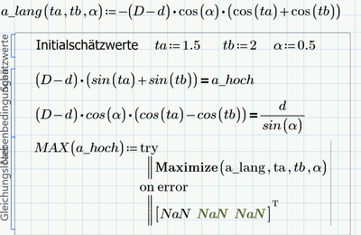

I notice that the second equation in your solve block differs from the one given in the thread referenced. You used "(D-d)" while @PL_14431742  had used just "D".

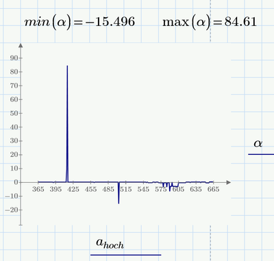

According your angles being that different compared to ones shown by Terry the only explanation which comes to my mind is that you are using different Prime versions and maybe the numeric algorithm used by "maximize" had changed. Actually the results you get are correct, too, given the periodicity of the sine and cosine functions. You get Terry's values for the first few entries if you add 30 time 2 pi.
Even in Prime 11 the angle values we get for alpha run from -15.5 up to 84.6.
You could add an additional constraint like   0<=alpha<=2 pi  in the solve block but this would make the solve block fail now and then for some values of a_hoch. It might be a good idea to use a "try...onerror..." in the solve block in case maximize can't find a solution for one reason or another:
A better approach for the angle correction might be to correct the angles after they were calculated by the solve block.

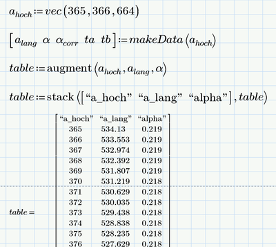

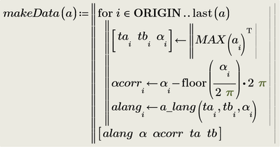

Here is a function which works four time faster than what was shown so far and it returns not only alpha, but also the value of alpha corrected to be in the range from 0 to 2 pi and it also provides the angle values ta and ta.
The parameter "a"of this function is a vector of a_hoch values.

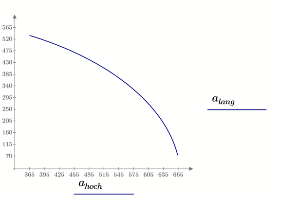

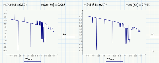

If you compare the angles in alpha_corr with the ones in alpha you can see that they all lie in the range from 0 to 2pi, but we don't get a continuous curve if we plot them over a_hoch. Not sure if this is to be expected.
This on contrary to "a_lang" which makes a nice continuous curve

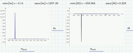

Angles ta and tb also show extreme values
Once we apply a similar correction as with alpha it looks like this:

I don't have Prime 7 installed, so you will have to retype from the pictures sent.
What do you see when you evaluate MAX(365)?
In Prime 11 I get using the sheet you posted
Find attached a pdf print of the file I used.

I just opened your file in Prime 10 and also in Prime 9 (the oldest full version I have installed) and can say that the underlying numeric algorithm sure has been changed when going from P9 to P10.
Prime 10 shows the very same results as shown above with Prime 11.
But the results in Prime 9 (again just using your sheet) are completely different:
Nonetheless the results are correct and lead to the very same value of a_lang.

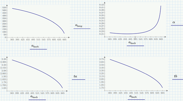

I continued playing with the (P11) sheet and tried to get continuous values for the three angled involved.

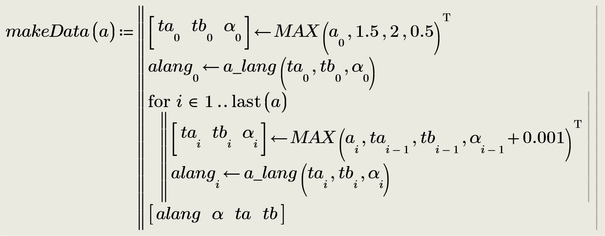

In a first step I turned the solve block into a function with the three guesses as additional arguments:
Then I modified my "makeData" function so that it uses your initial guesses just for the first value calculated and after that uses the results of the previous calculation as guess values for the next one. Doing so makes the solve block fail already for the second value (366). A bold fix was to add a small amount (0,001) to the alpha guess (not sure why this cured the problem.
These modifications resulted in nice continuos angle values (in Prime 11)
which of course is also shown in the plots (without any need to force the results to the interval [0; 2 pi).
You may try in your Prime 7 if you can find initial guess values (maybe using values close to the ones seen in th efirst row of the table shown above) which give you the same results for MAX(365) as I had shown in Prime 11.
Prime 11 file attached, for whatever it may be worth (maybe someone is able and willing to convert it into P7 format for you)
