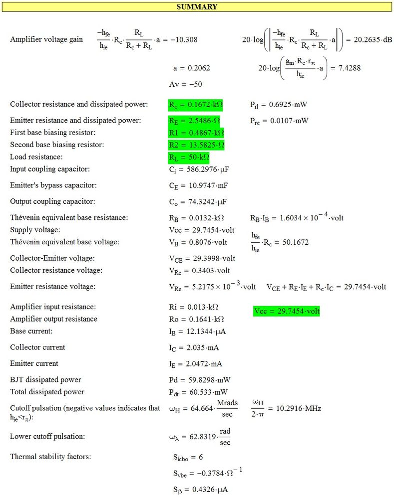

Sir, to perform Stress and worst case analysis on a Component level.

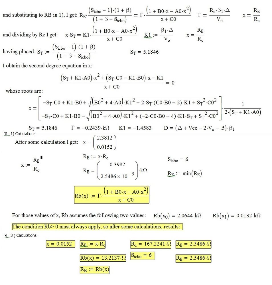

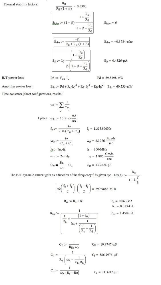

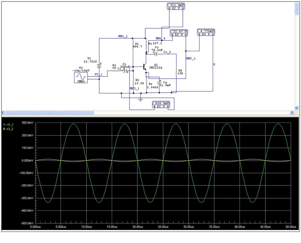

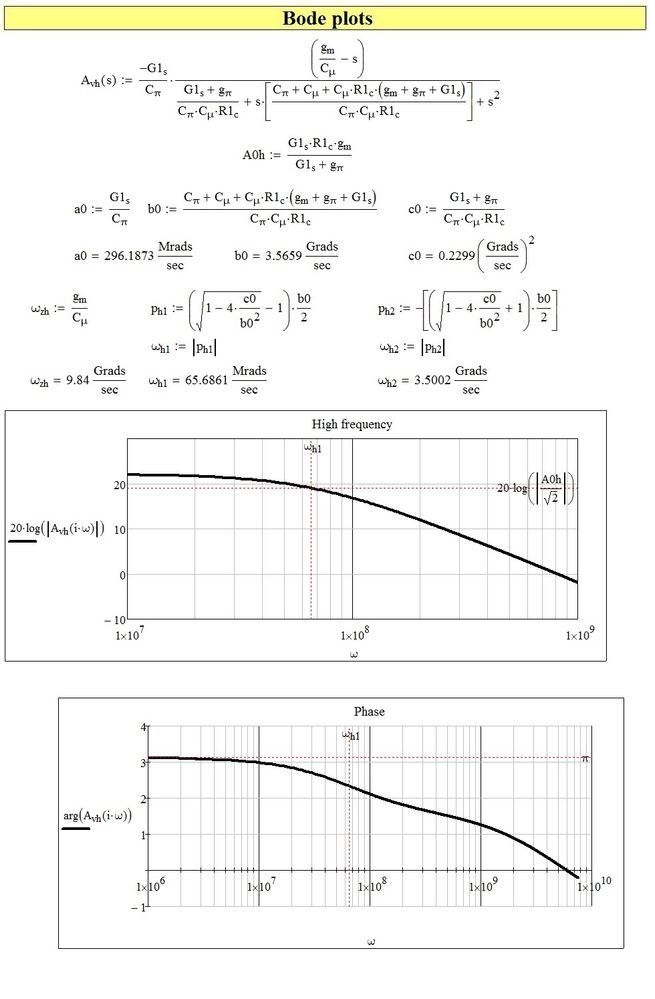

Maybe something like the attached? There're P4 so I hope you can open them.
Norm

so sorry. i could not open.
Can you please help me with this

Answer to:
please, what do you want?
- Mark as New
- Bookmark
- Subscribe
- Mute
- Subscribe to RSS Feed
- Permalink
- Notify Moderator
this is one of the correct answer. Thank You So much. I could open these files.
This is relevant to the question asked by me(another ID).
Thank you So much. I totally get it now.
