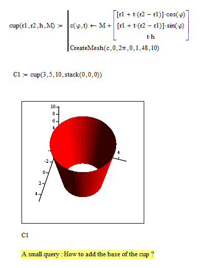

Hello Everyone.
From :
How to plot a cup ?
Thanks in advance for your time and help.

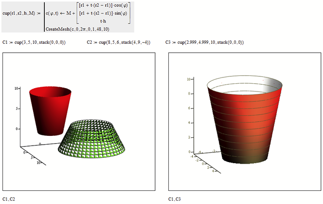

(To:lvl107)
One of many possible ways
lvl107
20-Turquoise
(To:Werner_E)
I greatly appreciate your time and help, Werner. Still have a very small query : How to add the base of the cup ?
Best Regards.
(To:lvl107)
Just don't fill liquid in the cup 🙂

Now you can fill in liquid or trap a fly underneath 😉
lvl107
20-Turquoise
(To:Werner_E)
"Now you can fill in liquid or trap a fly underneath"

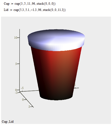

Werner, I'm imagining I could fill in hot coffee now 🙂 and want keep it warm. And how to add the lid of the cup ?
    Best Regards.
       Loi.
(To:lvl107)
You won't be able to access your coffee if you add the lid. But you can use the very same principle to add the tp surface as I did with the bottom (which gets the top if the height is negative, as you could see).
Simply map for example the interval from 1 to 2 for t to the range from r2 to 0 using another if statement in the definition of f(t). I'll leave it as an exercise for you to do 😉
But you sure could simply add a (slightly larger) lid as a separate cone of only marginal (negative) height:

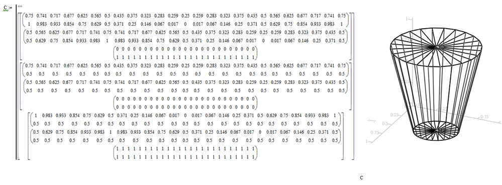

lvl107
20-Turquoise
(To:Werner_E)

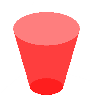

Werner, follow your hint and do exercise, I guess now I could "trap a fly underneath" : 🙂
Best Regards.
