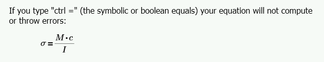

I want to type in a formular in MathCAD just for demonstration, i don't want MathCAD to run or calculate it.
For example following equetions: it throw me error that variable is not defined.
