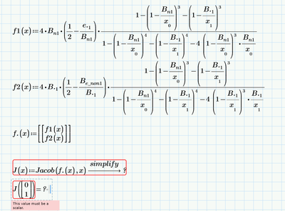

I'm having a hard time setting up the function to solve. Any help would be appreciated. I've attached a file of what I'm working on. I'm using MathCAD Prime 8.

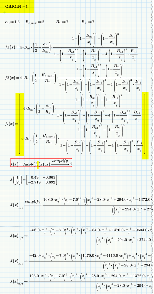

  1. By default vector- and matrix-indices start with 0, but you used index 1 and 2 in your definitions.
    You can do this, but you would have to set the system variable ORIGIN to 1. Either via the menu or simply type ORIGIN:=1 at the top of the sheet
  2. Why did you define your function f.(x) as a nested matrix? A 2x1 matrix inside a 1x1 matrix. I guess a simple 2x1 matrix is all you need
  3. When you call the Jacob function you use f(x) as argument. But you called your function f.(x) (note the dot after "f", its part of the name
  4. You will get a message that the expression is to large to display but still van be used in further calculations. Thats an annoying "feature" but usually there is not much you can do. In your case you are allowed to display the four entries of the Jacobi matrix singly as shown in the picture below
BTW, as you already defined your functions f1(x) and f2(x), you should make use of them when you define f.(x)

In the definition of f.(x) I still see two pairs of square brackets! That means that you still define a nested 1x1 matrix with a 2x1 matrix as its element.
You have to delete the outer pair of square brackets. It should just be a 2x1 matrix/vector with the two function definitions as its elements.

I opened your sheet in Prime 9, let it recalculate without changing anything and it worked OK
I would have expected kind of a division by zero error if x[0 is set to zero ...
Maybe it worked OK due to a bug fix/improvement to the symbolic engine they made from P8 to p9 ?

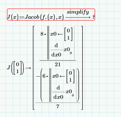

I vaguely remember of a bug in Primes symbolic engine which also turns matrix indices to float numbers, when the symbolic was forced to float mode (which is the case if non-integer numbers are used). Later calculations would then fail because of a vector index 0.1 or 1.0.
You can check if thats still the case in P8 by just evaluating f1(x) after you had defined the function. You should see
If you see x with index 0,0 and 1,0, then the bug still is present in P8 and was only fixed in P9.
Try to replace the 1.5 for variable e.1 by 3/2, let the sheet recalculate and see if it helps.

The evaluation of f1(x) returned the same solution you showed. I tried what you suggested for e1  and this is what was returned:
(To:JA_10710615)
As far as I can see I did not use a symbolic evaluation but rather a numeric one.
But I just tried and I get
So all that can be said is that the implementation of the Jacob function seems to have been significantly improved in Prime 9.
You may try to upgrade if possible or use a user defined Jacobian function as shown in a previous answer.

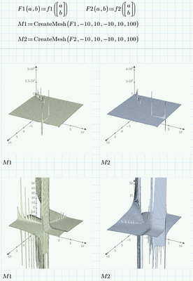

But again - your specific system is very unstable and an approximation method may give you "random" solutions depending on the guess vector.
I have plotted the two functions and it looks like they return most of the times a value around zero with the exceptions of some "spikes". So there may be a lot of positions, where both are around zero (within numerical precision) and this could explain the many different "solutions" you get depending on the guess value. So its sure not the best example for learning and demonstrating the Newton algorithm - which seems to be the purpose, as otherwise you simply could use Primes built-in numerical method (solve block with "find")  as shown in my previous answer.
