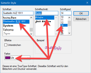

I guess you don't want to change all variable names to use Sütterlin.
So I would suggest that you define a user format (Menu: Format-Equation) to use that specific font in the size and color you like.
Whenever you want to use a variable name of style Sütterlin, you first type the name (it will be normal "variable" style by default) and then change it to "Sütterlin Style" (or whatever description you had chosen) vie the Formatting toolbar.
Werner_E_0-1675624831318.png  Werner_E_1-1675624860932.png  Werner_E_3-1675624935223.png
BTW, I installed two truetype Sütterlin Fonts, but only one of them was offered by Mathcad in the menu. Not sure why the other was not in he list. I was able to use the other one as well using a trick (first chose any font, create a variable of that style and change its font using the format menu).
