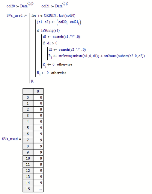

Good afternoon,
I have a multi-column txt file. I want to perform an operation on two fields. Each of them has the following layout: number/number (eg. 4/5 or 4/5). I need to extract the first character from both of them and then add (eg 4/5 and 4/6 ==> 4 + 5 = 9) The problem is that MathCAD 15 reads the field as mathematical operation and gives me 1.0 or some fraction. How could I import it as a text, pick two characters, convert to INT and then get the result?

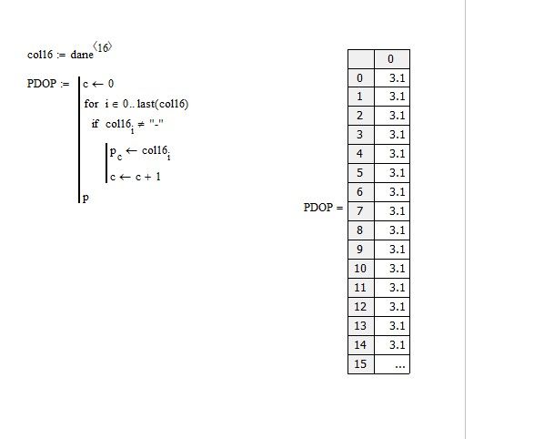

The second issue with the data is that some parameters are given only every 4th row, not each of them (eg. needed PDOP). I need to perform a simple statistic analysis (mean, stdev, min, max, med). As the columns with data (eg. PDOP) have empty rows I cannot do it.

The second part of your question is easy enough:
(though since all the values are the same it's not clear why you want to perform any stats on them!).
Alan

The first part is also not too bad. Essentially it means to read the file as a ";" delimited file and replace entries containing "/" with the result of calculation where "/" is replaced with "+".
See attached.

In the message the OP wrote "I need to extract the first character from both of them and then add" but the example he gave did differently! In the file once again he wrote
So maybe he is looking for something along the lines of

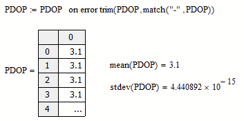

Here is an alternative solution to your second problem. The "on error" statement is necessary only in case that PDOP contains not a single entry with "-" as match would throw an error in that case.

Thank you, it works now. One final minor correction needed is to skip the first two lines in file. I tried to change the range to ORIGIN+2 but I was unsuccessful. With this, all would work perfectly.
Yes, that doesn't work. Try using the submatrix function on the result.
It would work if you additionally replace every R[i by R[i-2.
But I think using "submatrix" either on the result or on the input vectors col20 and col21 is a cleaner solution.
You could simply replace the last R by
