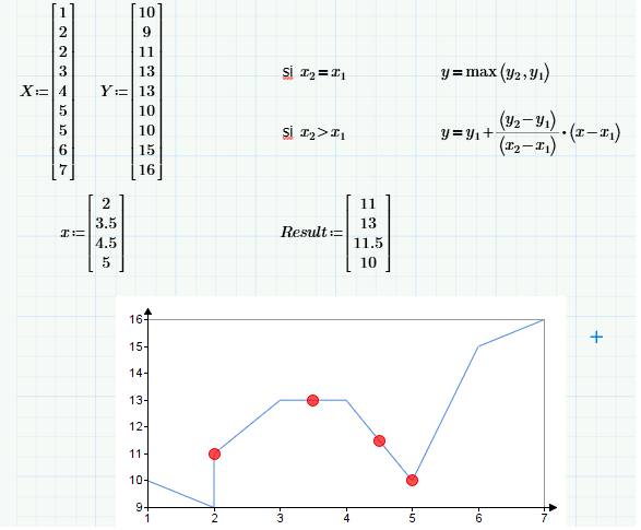

Good morning community. I am trying to interpolate with certain conditions with repetitive data, a way to program, please if someone give me an idea. Mathcad Prime 6.0.0.0 is being used.

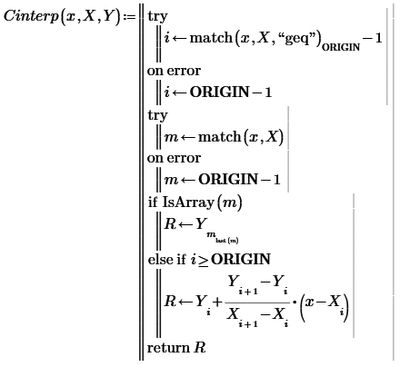

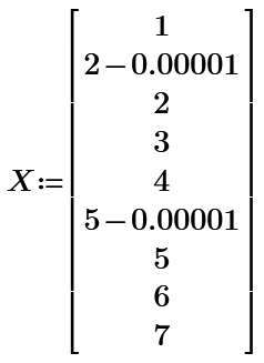

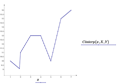

This should do it:
Translated by the Community Moderation using Google Translate
Esto debería hacerlo:
Ejemplo:
¡Éxito!

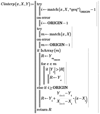

Thanks Luc, I'm learning to program in Mathcad prime 6.0.0, I'm a newbie, sorry for the insistence. Indeed it worked for me, the peculiarity now is that for negative values I want the result to be the value furthest from the origin.

Try this:
