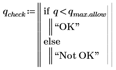

Hi everyone, I hope you are fine.
I need to change the color of the result word, if it was safe to be green and red in case of unsafe.

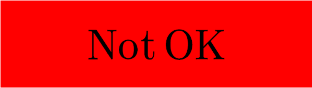

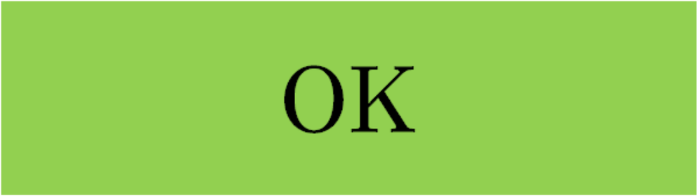

Prime does not support doing so. In old Mathcad we could achieve something like you demand by using scripted components, but Prime does not offer scripting.
There was a thread a while ago where it was suggested that the output text should actually be a cell in an embedded Excel sheet which of course could be colored depending on certain conditions. A quite elaborate solution for a simple problem, but at least it works.
See here: https://community.ptc.com/t5/Mathcad/Color-coded-results/m-p/862742/highlight/true#M205638
