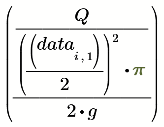

Are you sure that your expression
is correct?
According to what you wrote with
Hf=V2/2g*ft(L/D) where V=Q/[(D/2)^2*pi ]

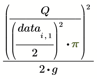

I would have rather expected it to be (partially) squared
or simplified
Werner, that is a good catch.  I was going through my sheet and noticed the error as well.  I've added some additional steps to make it more clear (to me) what I am solving for.  I tried to nest an if loop for Reynolds number within the X program.  It says I am utilizing the wrong units, but I have looked at it several times and it appears that I am using the correct units and solving things properly.  Would you mind taking a peek?  please note that I have only built this out for if data [i,2] = "Pipe" and have a bunch of notes in hidden areas.  I have updated both the Mathcad file and the excel file and I've posted the file as a pdf too.

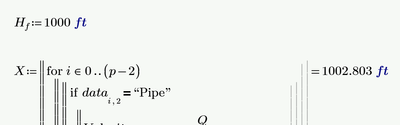

Devin
(To:Devin_2020)
As I understand it, you don't experience any errors anymore.
In the calculation of X I would suggest to initialize H.f for good style.
If H.f is not defined in the worksheet in front of the program, its does not matter as in a program an undefined variable which is used at the left and right side of an assignment is assumed to be zero.
You may see the need for initialization if you define H.f in the worksheet in front of your program
