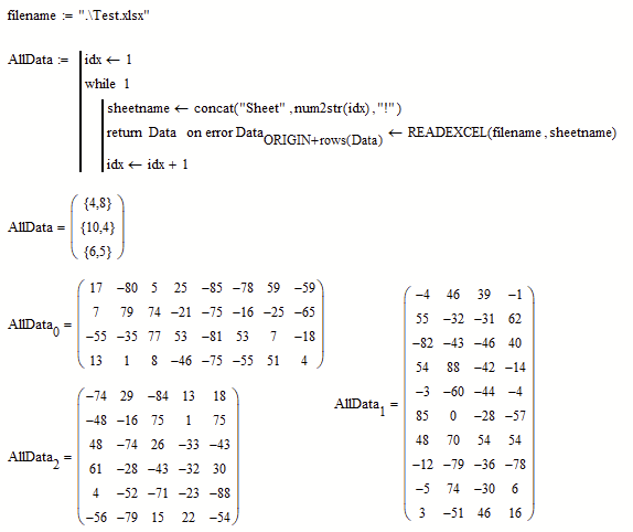

I don't know of any built-in way to get the number of sheets in an Excel file or (equally important) the names of the sheets.
As long as the names of all sheets are left at their default value (which is "Sheet" in English versions followed by a number starting by "1")  you can let Mathcad read in the sheets until it fails. Failing could mean that no further sheet is found but it could also mean that the next sheet has a different name.

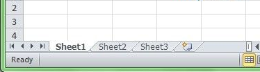

The attached demo Excel file consists of four sheets. The first three have the names "Sheet1", "Sheet2" and "Sheet3", but the fourth is names "Tabelle4" (which is the default name in the German Excel version).
The aforementioned approach will only read in the data from the first three sheets and stop.

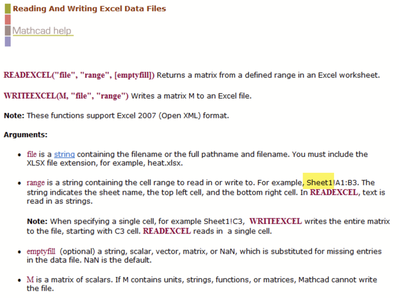

The "range" parameter provided in the READEXCEL function is just "Sheet1!" without providing a cell address and so the data from the whole sheet is read in.

Did I understand correctly: if you don't know exactly how many sheets there are, but know their names for any given number, then the problem is solved completely by finding out the moment when the error occurs when trying to read?

As long as all sheets are named the same ("Sheet" in my example) followed by consecutive numbers starting by 1, my approach should work and return a nested matrix with all sheets.
If the sheets are named "Sheet1", "Sheet2" and "Sheet4", my approach would only read in the first two sheets because when trying to access the non-existing "Sheet3" an error would occur.
