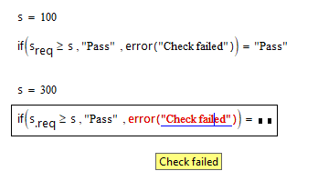

Here's a work-around (attached). The check has a red border if it has no return value.
Checks can be set up such that RED FLAGS are something that needs attention.
Unfortunately, red outlines are ALWAYS something that needs attention.
Nice thought!

The following works in Mathcad 15:
