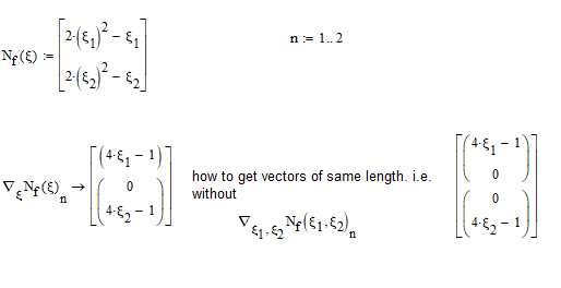

Hi, I want to get vectors of the same length. Is it possible to do this
Thanks in advance

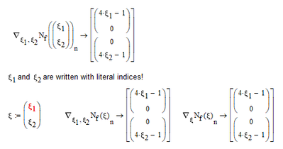

(To:ifomenko)
Maybe that way, using literal indices

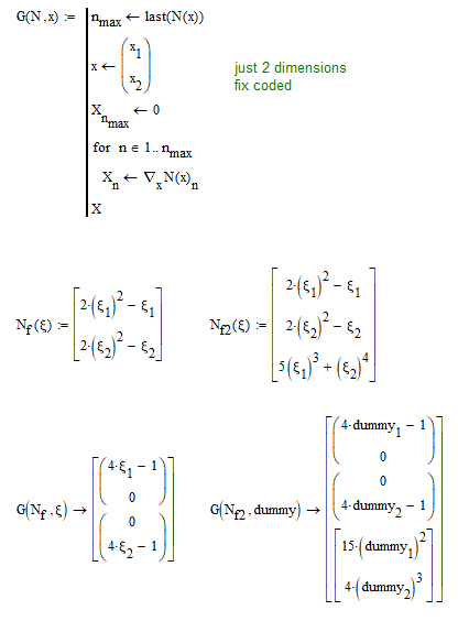

(To:Werner_E)
No, but you`ve given me a good idea
without literal indices

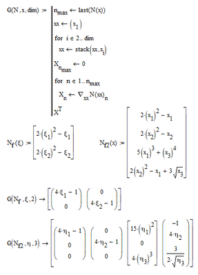

(To:ifomenko)
This function may be more versatile
(To:Werner_E)
Here is a more general version of the above

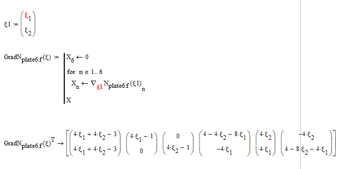

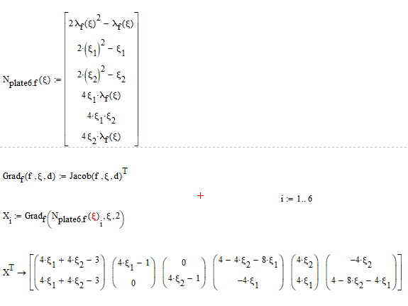

ifomenko
(To:Werner_E)
I remember may be a more elegant way by Jacob function
