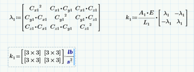

Is there a way to expand matrix with submatrices inside to single regular matrix?
yoohooos
I have this k_1 matrix
is there a way to expand this matrix to 6 by 6?

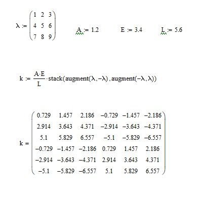

Like this perhaps:
This was done in MC15, but I expect it will work in Prime as well.
Alan

Like this perhaps:
Alan
Thank you very much! It worked!
